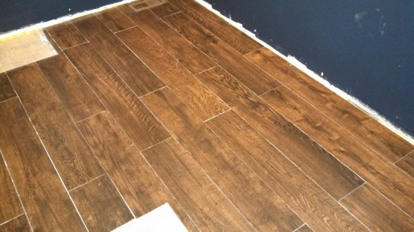

    I used those tiles from Lowes in my laundry room. They look fantastic, but at 48" long, they're a royal PITA to lay. Your subfloor has to be perfect. I'm just a novice tile layer, but a perfectionist, so it took me way too many hours to tile a 12x7 room. Looks great now though. I love those tiles, and get tons of compliments from the random people that end up in my laundry room lol

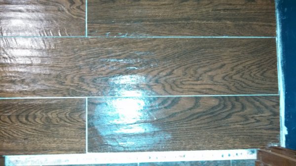

    Forgot I had pics on the computer. I took them with my phone, and forgot I transferred them a few months ago. For only being 34 years old...I'm not good with technology. Here goes...1st pic has cutouts for cabinets. Second pic is wet from wiping down after grouting. IMG_20140113_195948_203.jpg IMG_20140113_200014_709.jpg

    looks great, if you lay a similar tile again, stagger the joints more randomly. you should not get a pattern going.

    That was my initial plan, but the directions were specific about laying them in one of several patterns. I chose that pattern. Don't remember why exactly. That pattern isn't nearly as jarring in real life.
    With 48" tiles, I can see how a random pattern can be done. What about the 24" wood look tiles? It seems to me that you'd have to chose between joints that are abnormally close together or a pattern. How does that lay out?

    well first I would defer to the manufacturers recommendation, they have a reason for doing it and if there is a problem down the road you did follow their direction. Generally you would try to randomly stagger them with a minimum of a 6 inch offset. so on a 24 inch tile I would vary the stagger between 6 and 18 inches. Sometimes what will work is lay the length of the room and use the last cut off to start the next row. Then continue doing that as long as the stagger works out. Also minimizes waste.
