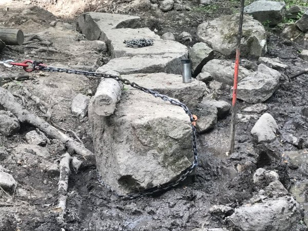

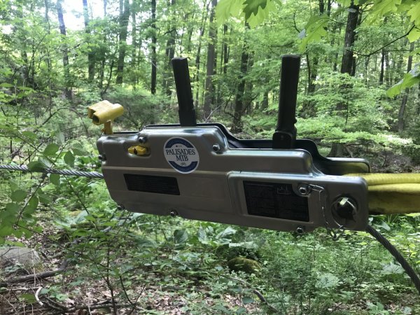

    I have a Grip Hoist. It’s way more tool than could be justified for firewood gathering. It costs about 100x what a 2 ton Harbor Freight goes for.
    It’s fun to use. This one primarily gets used for trail building to move large rocks/boulders. Industrially, one of my friends uses them for pipe fitting. I know another guy who was a stage hand and said they used them at times for lights etc. A pair of them can be used to raise/lower scaffolding.
    There’s no ratchet mechanism in it. The cable goes in either direction so you can raise/lower or slack off on something that you are pulling. The cable runs thru it so you are not limited by the capacity of a spool. You can rig temporary cable crossings over rivers, swamps or ravines with it.
    There’s a pipe lever that goes on the nubs.
    We pulled this rock level, then stuffed as much crushed rock under it as we could pound in, then released the cable tension.

    Simply amazing what can be accomplished with nothing more than pulleys and levers. I like that the cable goes through yours so you aren’t limited by spool capacity. That was an issue with mine but I got around that in my situation by also using a ratcheted tow strap. I did use one spool and it wasn’t enough so I released the tension, pulled the spool cable back out, did the tow strap tight and then went back to the come along pulley. Just one time back-and-forth and then it was on the ground. Reminded me of doing a three or four point turn but with ratchet pulleys if that makes any sense.

    Cool, never have seen one before... Always neat to see different tools of the trade... :handshake:

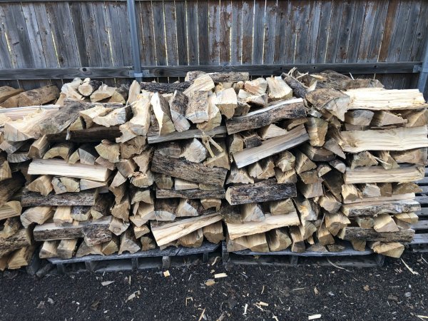

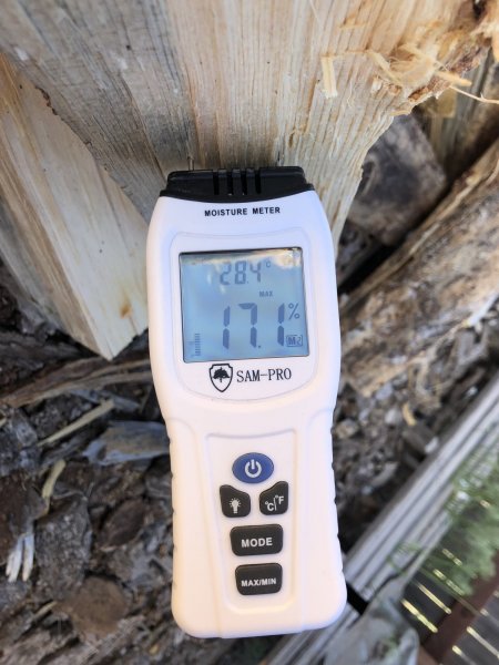

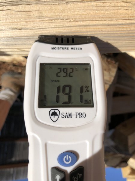

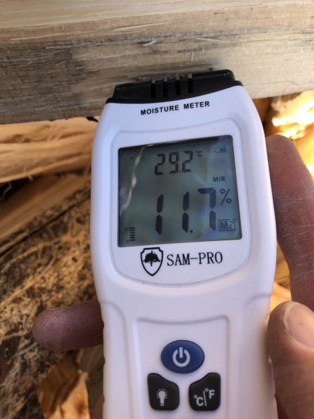

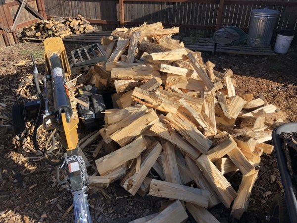

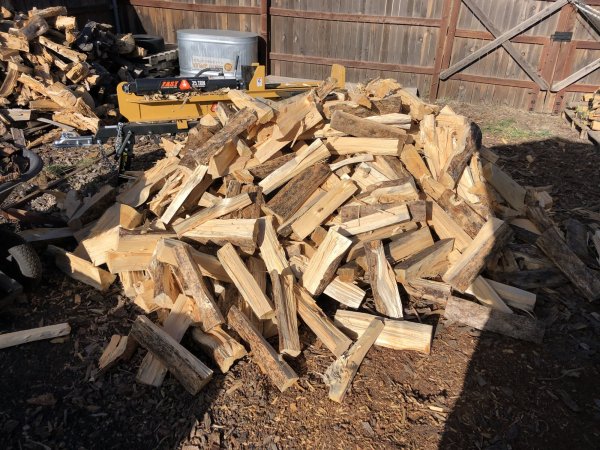

    Got it split and stacked today. Expectedly, the lower half had the sap. Came in at 19% on the moisture meter. Upper part was about 11%. This stuff dries fast once cracked open and exposed to air. Since it’s pine, it’s still a bit too wet for me to burn for my liking. But after sitting in the sun and wind this summer it should be good to go.

    Somewhere I’ve seen a photo post of masons using those as guidelines to drop huge rocks down steep hills. Built a staircase up from a river if I recall correctly.
    I’ve seen them used on FB marketplace. Even used they’re pricey. Very useful tools tho.
