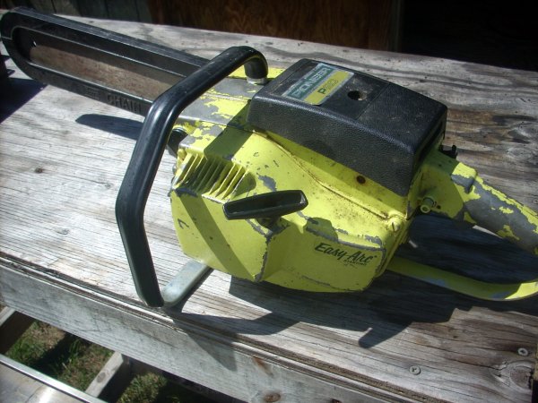

    Nope, I'm not getting into collecting old saws! :headbang: I came across another old saw, just couldn't pass up, Cheap....

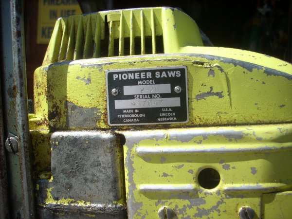

    The Chain guard says, "Sears" on it so I'm assuming they were sold in Sears. I have heard of them, never owned or saw one in person until now.

    I haven't tried yet, I blew out the air cleaner with my compressor, the tank was bone dry but smelled REAL bad, I pulled the plug and looked with my bore light to see if it had "any" oil residue in there, I sprayed some PB and a bit of marvel mystery oil in the cylinder, then pulled it through. It has real good compression. Plug could use a change so I'll get that and I did mix a small about of gas/oil about 32:1 just in case. The cap on it say's 16:1. I'll try later this evening, I put fresh gas in it with some Marvel Mystery oil in it. I'm gonna go slow and I might get lucky. This was a $50.00 find, Fella at my gun club.

    Yes, iT'S ALIVE!!!! :cool: It ran real well also. :tears: Took some time to get fuel through the carb and about 10 pulls, but once it did, She ran very well!!! I got a heavy mix in her, and it's still running great. It even idled for about 45 seconds fine. when she quit, it fired right back up on first pull!
    I think having the new plug was the key, It's a Stihl MS 250 plug but closely comparable I'm sure. I keep a few plugs on hand, They matched up perfectly. I'll get a factory Champion CJ6 which is what I took out. Seems to run real strong. I'm gonna let it sit for an hour and see if she'll fire up again. :yes:

    Thanks, it's a (strong) runner! I really don't think this was used much at all. The original bar on it is in nice shape, clutch still has factory paint on it that hasn't worn off, It just has "garage rash" from moving around. This model is from 1973 to 1976, so it's in there somewhere.
