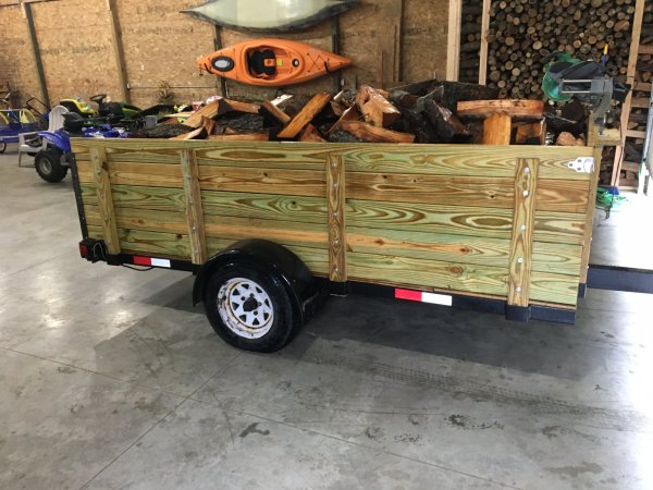

    Rebuilt my trailer this summer and hauled a lot of firewood this fall with it. The 5/4 deck board holds up pretty well! CDCCC559-3672-4821-AD61-5BAA4CE0DFBD.jpeg

    If you happen to have more pictures and including other angles I would be interested in seeing them. It looks great. Was that just a flat bed trailer with no sides or did you remove?

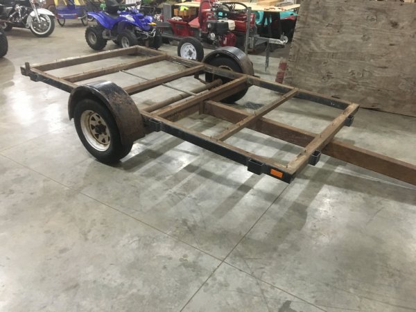

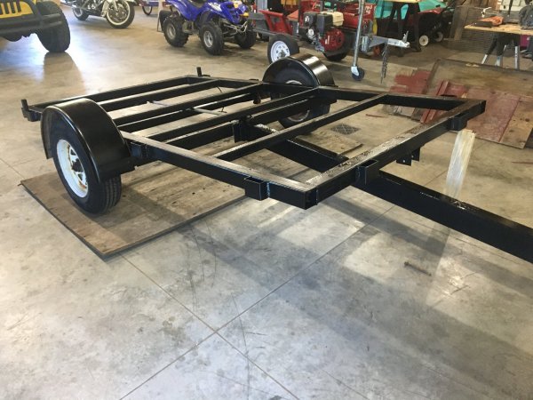

    This is the only pic I have left of what it used to look like. Sides were falling apart so I decided to finally deal with it:rofl: :lol: Welded stake pockets on sides and front. Wire wheeled the entire frame before priming and painting it. Ended up replacing the floor with the same treated 3/4 plywood. Angle works well on the back for sliding the two piece gate into, but I’d get an angle with one side longer next time. Not much to screw into on the side of the trailer after allowing for the gap the gait slides into! Ended up pretty sturdy overall. Tilts, so it also works well for four wheeler, lawnmower, and whatever else I put in it. New lights, reflective stickers and wiring too. 70299946-FC0E-4E7D-82B0-0F8057DFE03F.jpeg 6C9678C9-341E-46F6-8285-6EB499A83755.jpeg 32C00A14-08EF-4A9F-AFD1-33CD961ADB7F.jpeg 2EF96A39-656A-4D28-A003-2193066DF881.jpeg 462749D5-FA03-4597-BA20-376B1C81206A.jpeg

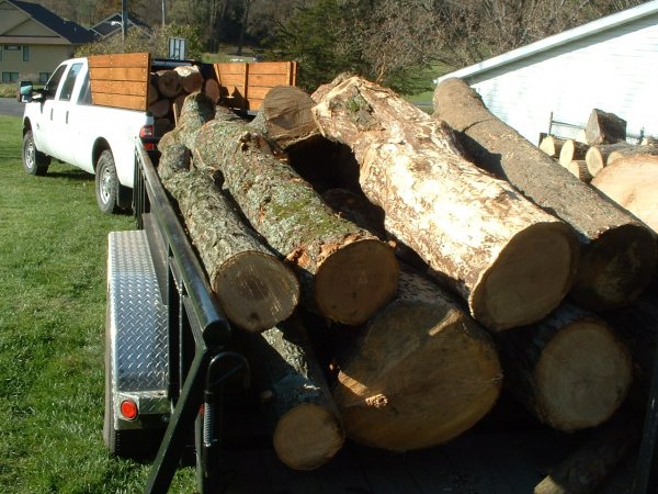

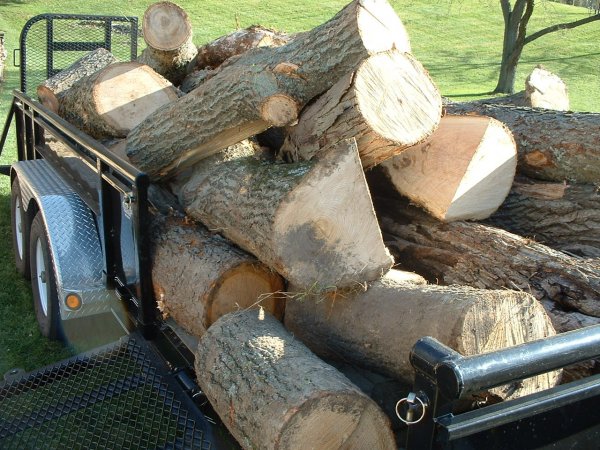

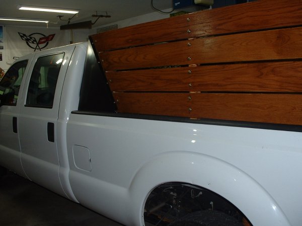

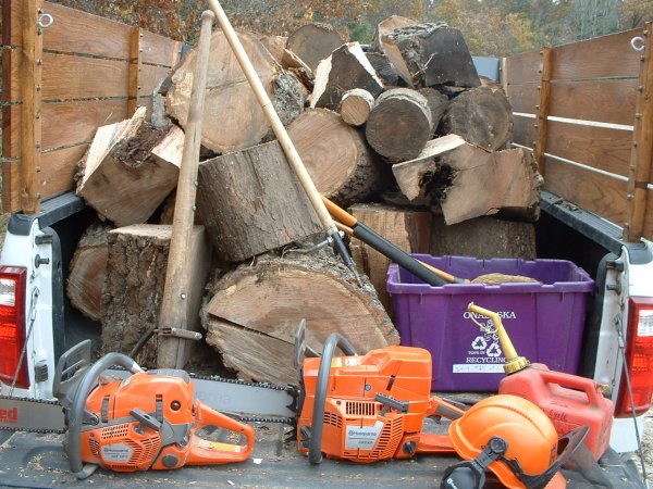

    First thing I did on my truck with 8' box was a head ache rack to protect back window. Put on side racks and Timbren overload springs rated at 8,000#s.
    Trailer is 18', with twin 5200# axels, cross bracing on 12" centers, split heavy duty ramps with knee bracing rated at 7,000#s and dove tail rear.

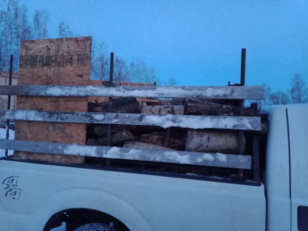

    IMG_20211105_174414164.jpg not a very good pic.
    Made from 1" angle steel and rough cut 2x4
    The bed rail and headache rack were separate and always stay on the truck the wood rack is on / off easily I need to add 1 more 2x4 to the top so I can haul 256 cubic feet of wood per load
