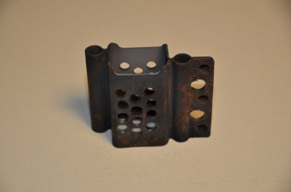

    Here is a photo of the baffle I modified for the 250 (same as I did for the 025) but then decided to just remove completely. The holes were only on the one side, the bottom as I remember. I drilled those holes straight through (enlarged them a little too I think), plus added the two larger holes to the tab that points to the left. Original exhaust flow was out the port, down through the original holes, around the baffle to the left of the tab, and out the muffler at the top front gill slits. This modification allowed exhaust to pass right through both top and bottom, as well as facilitate passage around/through the left tab, to the top front gill slits. With this modification, the 025 ran "real nice". On the 250, after modifying the baffle, I just decided to leave the baffle out and see how it ran (wide open from the port to the front gill slits). Be advised that the baffle is also meant to support the front cover as its tightened down with the nuts, but I gently tightened the front cover down till things were snug and tried it out. It ran "real nice/great", so I just decided to leave it out entirely. I've sold both of those saws after running almost 2 tanks through them and they had no problems up to that point. Also carefully bent/rounded the existing gill slits wide open on the front cover.

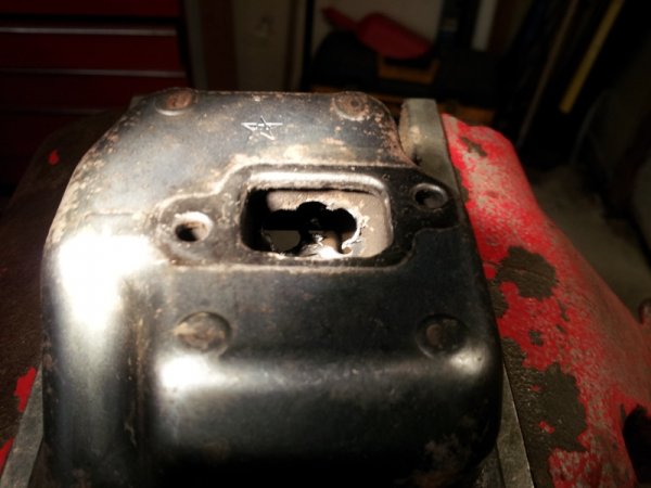

  5. Bret Hart
    Bret Hart
    1,061
    3,817
    Central NY

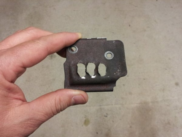

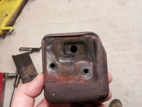

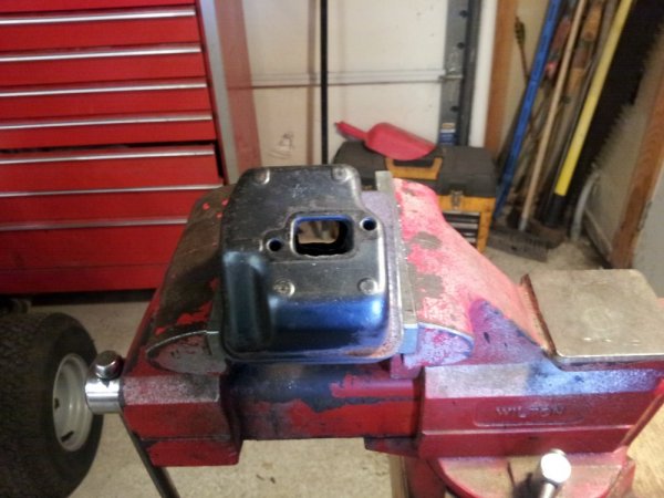

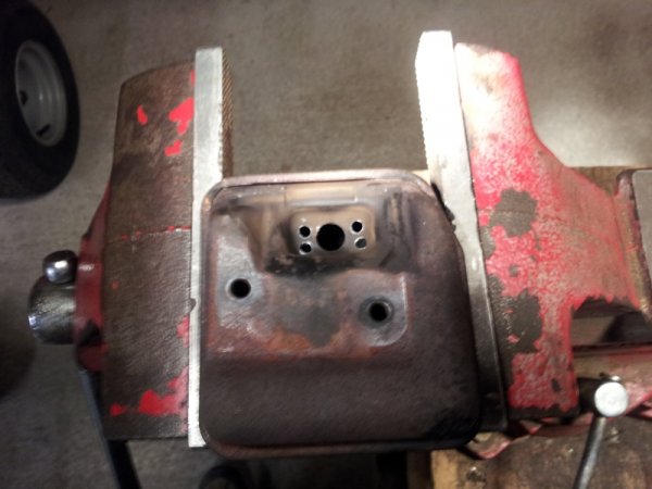

    Got started on the muffler last night. Not pretty yet but I still need to pick up a few new carbide bits to finish the job.

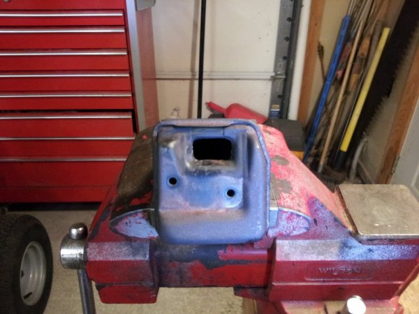

  6. clemsonfor
    clemsonfor
    15,996
    37,478
    Greenwood county SC
    You can even hog out that whole area with the 5 holes in it. The one I did on the 390 was a tame mod. I think I may do more to it later.
    Ur looking good, I promise you that you will tell a difference. It will be like running one saw larger.

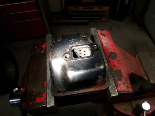

    Got the muffler finished but still need to tune the carb. A bunch of paying work showed up so the saw is going to have to wait. Time to get the reel grinder fired up.:D
