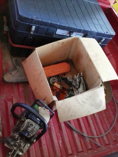

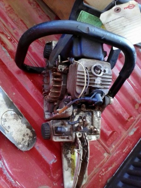

    Just put together a parts list for the 260 pro and it's a long list. Even found some of the cooling fins on the jug snapped off and some very slight scoring on the piston on the exhaust side so it's looking like it might not be worth fixing.

    Yea if you need plastic and going P/C u be better to part it. But if u just put a meteor piston and plastic from china you won't be in it for too much. But a full aftermarket p/C and a bunch of parts you will be pricy fast.
    Look up eBay just about every thing is there. Also I have a guy who deals in saws on eBay he has tons of stuff. I called him up after messaging him. He put all the parts I wanted in a bag and I paid him by PayPal. Way cheaper. Then piecemeal ing them off auction or buying at dealer.

    You could convert the 250 to an 18" 3/8" Picco setup.
    Top end kits for a 260 can be had for cheap. Even OEM isn't bad. As long as you have most of the parts and the bottom end is good, I say put it together.

    I'd say if u can be in for less than $200 build it.
    The broken fins won't hurt it, I would just try to replace piston if C is not scratched
