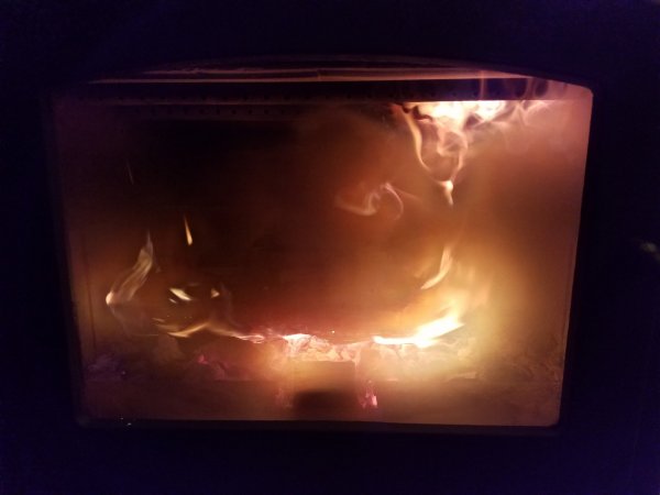

    How's this one for ya? Just loaded up some elm for the night :ithappened::ithappened::ithappened:
    Thor, papadave, Maina and 4 others like this.
