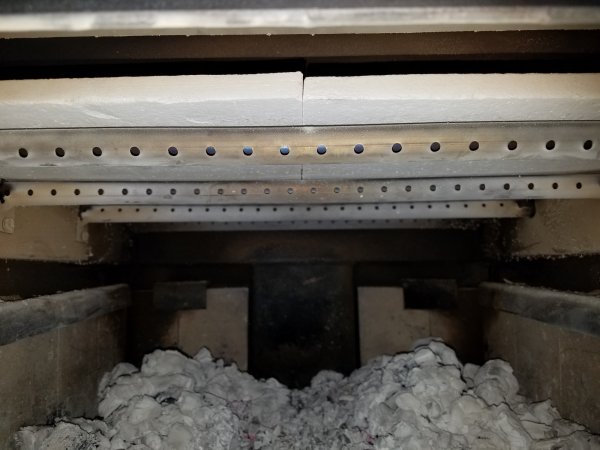

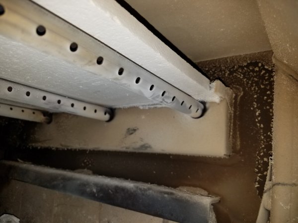

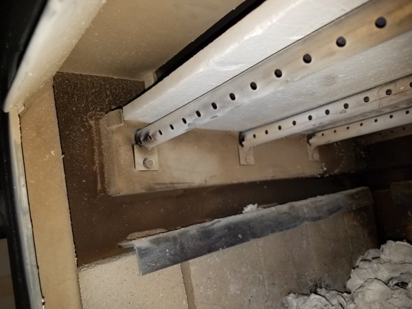

    Here's some pics I took. The baffle boards were in correctly. It is just the very front of them that seems to have bowed upwards.
  9. bushpilot
    bushpilot
    Feb 25, 2015
    3,240
    14,366
    Eastern Washington

    Next time you have them out for sweeping I would flip them so that they are cupped down. You don’t want them sticking up in the way of the flow.
    Did you or esw put that chunk of gasket material on the side of the board?
    brenndatomu and Marvin like this.

    I put that in to try to fill some of the gap.
    Highbeam and brenndatomu like this.
  15. HDRock
    17,268
    60,522
    I suppose it could reduce your air flow over the top of the boards if they warped too much
