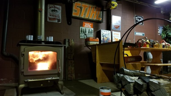

    The pot/Rheostat broke on the big blower I have. So its wired 100% on (plugged in) or off (unplugged). So if we have a fire, the blower is on high always. I've had a few fires that I remove the convection deck and keep the blower off, but for the most part the blower is always on to get the most heat. (Pic from the last little reload).

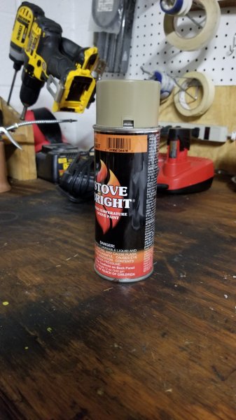

    Being a basement stove, we normally run her pretty hot. That said, if you want to make a basement stove a little fancy? Stove Bright makes a bunch of high temp colors. It took 3 cans for us to do our 30-NC a few years back and its held up pretty well. I have a few colors that were bought for our upstairs pellet stove (burgandy and dark blue) but have yet to use them.

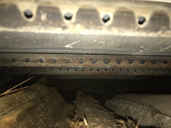

    My baffle boards have certainly bowed. In my case they only touch the front and back tubes, not the middle. Maybe a 3/16” clearance in the middle. Both are evenly bowed. They have changed shape for some reason and over the last 6 or so years I’ve been burning the nc30 I have not flipped them top/bottom. Maybe end to end.

    As long as no external parts glow you’re in compliance with the manual right?
    I wonder if flipping the boards will cause them to straighten out?

    I tried to take a pic.
