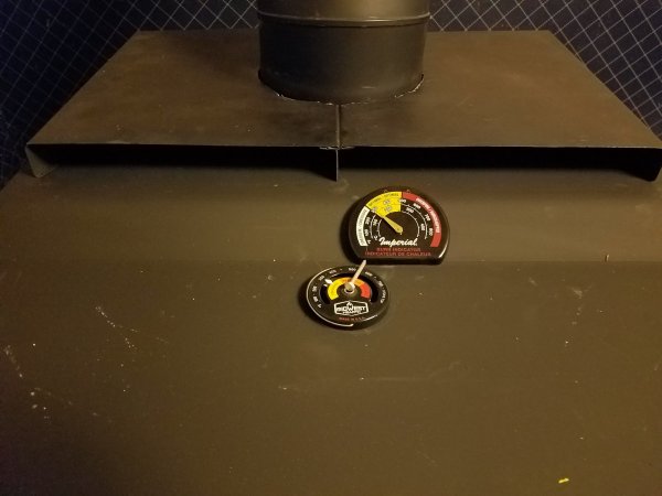

    Got the convection deck installed...
    Thanks again brenndatomu! Now all I need is some cold weather to see what this thing can really do :thumbs:

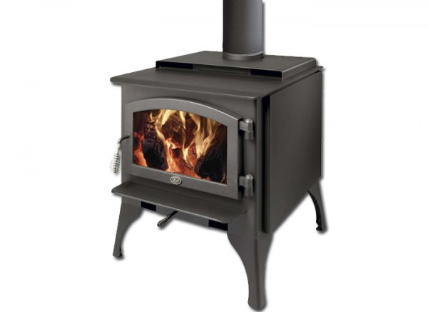

  3. HDRock
    17,268
    60,522
    You will really like the amount of heat you get coming out of the front of the stove with the blower on and that deck on there .
    My Stove comes comes stock with one on it and I love it.,
    Remember with that deck there and the blower on, Your stove top thermometers Will be lying to you, As the air moving over them Will keep them cooler and then The actual stove top temp is

  8. DexterDay
    DexterDay Administrator
    12,411
    31,637
    Northeast Oh
    Take caution running it without the blower on because the Stove top will get far hotter. That added steel plate will insulate the heat. Best to get a probe type thermo for your flue
    If I am not going to run the blower? I take the convection deck off to stop the build up of heat.
    Last thing you want is to warp something.

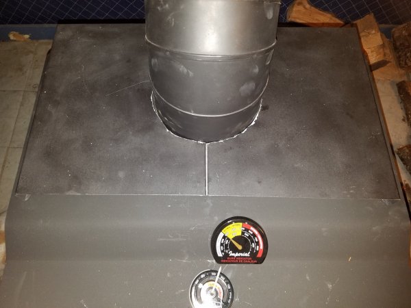

    Here is mine
    papadave, Thor, Chaz and 6 others like this.
