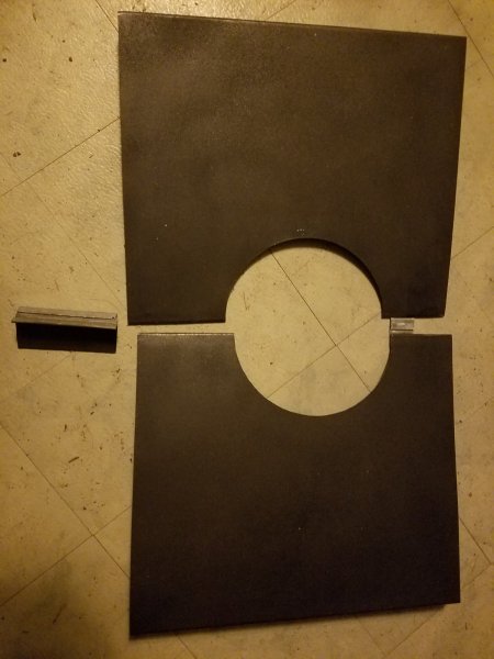

    Got home from work today to find a package on my porch :ups:
    I received a nicely made convection deck from brenndatomu :dancer:
    Pics of it on the stove will have to wait. I'm just getting home from a work Christmas party for the evening. I also have to modify it just a wee bit so it will fit my double wall stove pipe.

    As far as opening the pipe hole up a bit, there are obviously a few different ways to do it...some type of calipers would give you a good way to measure from the existing edge and mark a nice even cut line...I use Vernier calipers for this all the time...the tip of one jaw hooked on the edge, the other jaw tip (nose down) will leave a light mark in the paint. If you have (or can borrow) a left and right hand (red, and green handle) tin snips, that would make a half decent inside circle cut like that...I used a ductwork round hole cutter the first time, but those don't work too well to open up an existing hole.
    But I'm sure you have this all under control already anyways! :yes:
