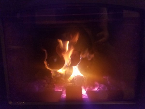

    24 hr update....
    The stove has been in for about 24 hrs now. So far I love it. That being said I cant give a thorough review of how it works with my setup just yet. I haven't fully put it to the test yet but will pack her full tonight for the overnight burn :D
    First impression....that firebox is huge! I really hope I can get it dialed in because I feel like this thing could really eat away at the wood pile. I swung in at lunch time to check on it. House was 70* outside was around 31*. I put a few small elm splits on the coal bed to get it through until I got home at 430. House was 71* when I got home outside 26*.
    Just threw in a few small elm rounds (branch pieces 2-3") to hold until the overnight load. I have no doubt once I get it dialed in it will burn all day for me while I'm at work:thumbs:

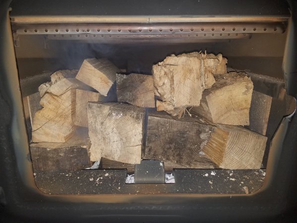

    Loaded it up pretty good tonight. Could have gotten a few more pieces but we'll see what this load does...

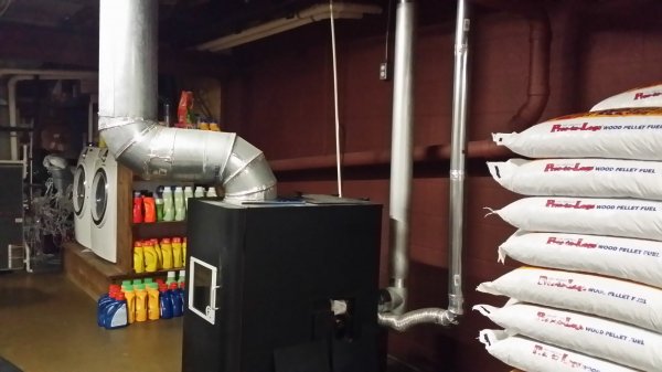

  19. DexterDay
    DexterDay Administrator
    12,411
    31,637
    Northeast Oh
    It's all standard 3" rigid and flex for the OAK. Also the same setup for our Pellet furnace downstairs.
    I can snap a pic of the outside if needed?
    I know there is one on my phone. But bedtime is approaching and we are trying to get my sons Eagle scout stuff in order.

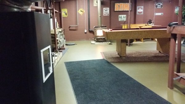

  20. DexterDay
    12,411
    31,637
    Northeast Oh
    And yes.. ! With 21 ft of vertical it still runs pretty hot. After several years we have learned that's the nature of the beast.
    No low and slow unless it's a few splits.
