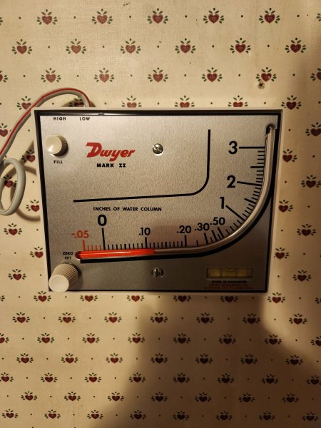

    Got the manometer hooked up...
    I hooked it in to the low side so I can use the positive side of the gauge. This pic was taken right after I put a few pieces in. They only had a small flame going on them.

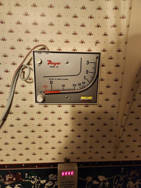

    About 10 minutes later after the wood started burning well...
    I guess this explains some things.

    Ideally when things are good n hot the reading would max out about where its at in the first pic (-0.06")
    Someone needs to close that damper...:)
    I've said for a long time...I think more people have stoves that are overdrafting than not...

    So, the higher the number, the higher the draft? The more the red goes towards the "3" the greater the draft?
    Marvin and brenndatomu like this.
  6. brenndatomu
    25,349
    165,086
    Yes

    The way I read the first pic, is 0.06. But brenndatomu, you said it was -0.06 ....
    What am I not getting...?
    Also, previously, you said the highest you'd seen was -0.08. If highest means highest draft, that would be a + number on the meter, wouldn't it? Or are the +/- reversed or something?
    So, in the second picture, it looks like it's showing around .11. Is that too much draft?

    I hooked the line in to the opposite input of what it would be on a furnace if I understood correctly from some of the info I've read about these. This allows me to measure the draft on the positive side of 0 where I have 3 inches of water column versus the negative side which only measures to -0.5 inches of water column.
    Draft is a negative pressure hence normally it is referred to in negative numbers.
    I hope that explanation makes sense. It's a bit 'bro-sciency' so I could be totally off base.

    Ok, I see what the issue is here...yes, we are using the meter backwards (as far as how its labeled) and you caught me...I did say -0.08" was the highest recommended draft that I've seen...highest in effect (lots of draft...which is a negative pressure (or some might say a vacuum) but yes, since its actually a negative number, I really should have said lowest.
    Any of that make sense, or just make more confused?

    So now that I have the manometer installed I've discovered that the primary air control has no effect on the pull of the draft. It certainly effects the fire (if I close the air the whole way it will kill the flame) but does not have any effect on the draft. The only way I can slow the draft is by closing the pipe damper partially. I set the damper right around straight vertically to get the proper reading on the manometer (this usually puts the draft around 0.05 IC).
    Is this normal?
    It has definitely made a difference as far as heating goes. I'm getting a much more even heat throughout the entire house as well as using less wood. I don't think I've had to stuff it full yet since using the damper due to the mild temps we've been getting the last few days. I call that a win.
