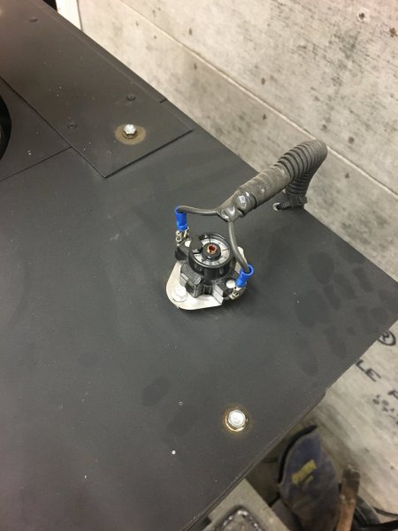

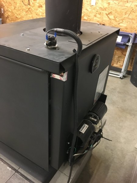

    What does that little doohickey do?

    It's a thermal switch. Simply; it turns the fan on when it gets hot.
    They are in quite a few devices, some working the opposite way, turning off when hot.

    Highbeam, can you explain this please? Does this mean that running the blower at lower temps causes a less desirable (potentially dirty) burn?

    Some people think so...I disagree (unless, maybe, on a old stove with no firebrick liner)
    My Kuuma wood furnace has a thermocouple inside the firebox...I have a temp gauge wired inline on it, it does not flinch one bit if the blower kicks on/off.

    I doubt you're gonna impact the burn inside the stove too.
    I also however doubt that at low temps there's very little (worthwhile) heat extraction happening with the fan, so why waste the electricity ?

    It’s a way oversized blower and with the convection deck plus additional fins under the deck I was worried about overcooling. My design is not as well engineered as an actual furnace that has been tested. A lot more heat is stripped from the stove with the blowers, I need to turn it up when they are running. Furnaces like the kuma do this automatically.
    The biggest reason for me is the automatic on and off at the beginning and end of the burn. This stove is in an outbuilding and I tend to leave while the stove is hot. I don’t want to run the fan 24/7 or futz with turning the thing on and off manually.
