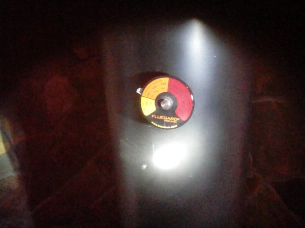

    I don't monitor STT, so I have no idea what is normal for my installation. I run off of my Condar flue gage, and if I keep it in the orange band, it does OK by me. That, and the way the flame looks is how I manage it. I consider the STT a result of good fire management, so if I get the fire right, the STT will follow.

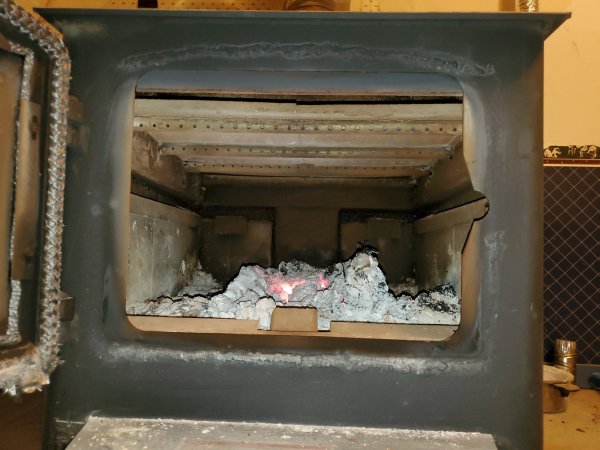

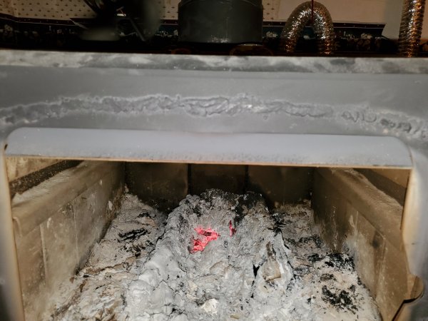

    Just wanted to give a little update to this thread since I did a little work on my nc30 this summer. I put a straight edge on the door opening and found out it was bowed in slightly on the top and bottom. I may have mentioned this earlier in the thread but I can't remember for sure. Anyway I used a flux core welder on the bowed spots to put a bead on that seals up with the gasket nicely. I used an angle grinder to try to make it as level as possible all around the opening. It is ugly as chit but it seals great now.
    I also replaced the glass gasket the other day.
    Temps have only gotten down to around freezing but 3 or 4 splits gets the house warm enough to almost have to open windows now. Granted the wood im burning is much more dry than I've had in the past but the stove is so much easier to set and forget. That is heating from the basement as well. I'm curious to see how it goes with actual cold and full loads this winter.

    Marvin , hat tip to you Sir. You identified a problem and corrected it. Good job. :yes:

    Looks great Marvin. It’s hard to control a stove if it’s sucking air in unexpected places. I bet you’ll be happier with it this winter and the dry wood will definitely help.

    My inlaws need a warped stove...they just continue to burn "low and slow"...the glass is always black :picard: a little extra air would be good.
