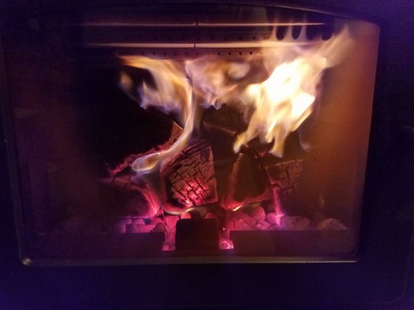

    We have ignition!
    Didn't load it up a lot considering this is the first real burn and it's late. I wanna be able to load it before work. I've already noticed a HUGE improvement on control. Also, I understand how some here talk about loading the stove in the morning and getting a cup of coffee before starting to set the air. That never made sense to me cause if I would have let the air wide open on the Osburn for more than 5-10 minutes I would have had 900* flue temps. This stove has a much much more controlled rise in flue temp. So far I'm liking it but its obviously still early in my experience with it.

    nice, enjoy the heat!

    Wait till you get to stretch it’s legs out and let it cruise out on the interstate... get a thermal gun and learn your stove. The fire inside burn pattern, the smells, and the second magnet thermal gauge ( first holds up the second :rofl: :lol:). The thermal gun just verifies where I’m at... 650 to 700 is a good heat producer temperature... 750 to 800 I put the fan on high and shut down the air for a bit... the secondary’s really get rolling... but take it easy and learn the little quirks of it...

    Awesome! Can't wait to hear how it works out for you :dex:

    Congrats Marvin, great looking stove!!
