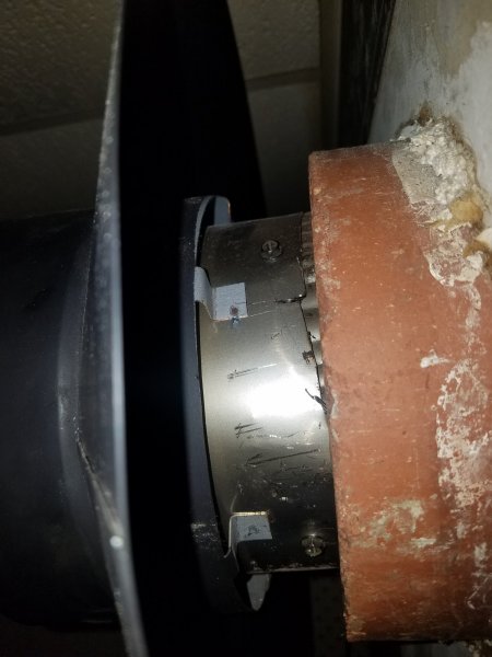

    I've got a draft question here. This post may get long...
    When I installed my liner and connected the tee snout to the stove pipe I didnt put any screws in it. The problem was I couldn't figure out how to squeeze screws in with the thimble in the way. I figured this wouldn't be an issue as long as I wasnt smacking the stove pipe around. Lately the stove has been acting strange. It was harder to control and the flue temps seemed way too high for the stove top temps I was running. I got to looking and discovered the stove pipe had slipped off of the snout. Fortunately the games were still exiting okay. My smoke detector and CO2 detector never picked anything up. Clearly this was not okay despite it's still pulling the gases out. Today I discovered I could pull the snout with the stove pipe adapter out just enough to drill some holes and put screws in. I feel much better about it now. Some pics...

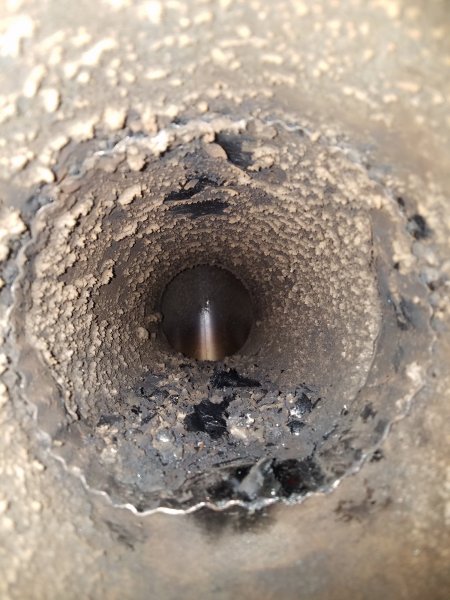

    Before...

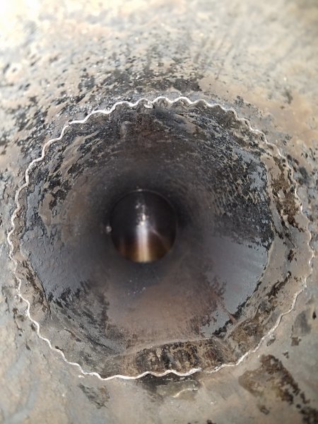

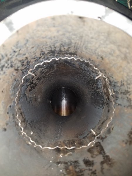

    After...

    I thought air getting in to the flue would slow the draft. It seemed to do the opposite in my situation. The flue temps are much more under control now as well. Does this make any sense? I would expect lower flue temps with air leaking in to the chimney.

    It should have...that is exactly how a barometric damper works, its basically a controlled/calibrated air leak that cools the chimney and slows the draft speed...

    Also the flue temp is so much more in line with the STT now (maybe the gauge is accurate after all). Before my flue temp was ALWAYS about 200-250* higher than my STT.
