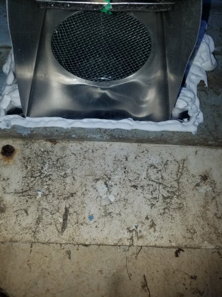

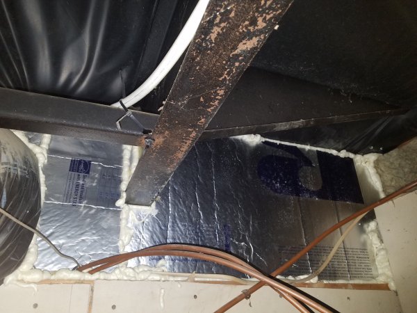

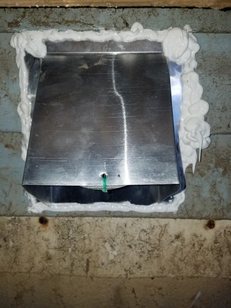

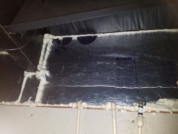

    Finished sealing up the basement from the garage and installed an OAK today. I didnt get a pic of the OAK outside. It's under the deck and I was crawling around in the dirt and mud to put it in. I have to get a tube of caulking to go around the edges so I'll snap a pic then.
    First two pics are from the garage looking towards the space above the basement drop ceiling. I pulled out all of the rolled insulation and replaced it with rigid. I sealed both inside and outside with canned spray foam. The third pic is the inside view of the OAK.

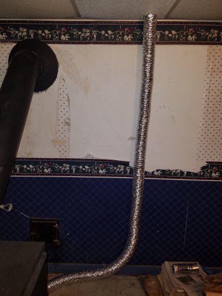

    brenndatomu you had mentioned a cold air trap for the OAK. Is there any specifics to this or could I just stick a hook in the wall to hang the flex vent from? That is kinda what I had in mind. I figured about 3 feet off of the floor...

    You could do that...doesn't need to be fancy...the taller it is, the more effective it will be at blocking "spillover" cold air.
    Just needs to come down, go back up, then back down...

    I was out crawling around under the deck yesterday to caulk around the OAK inlet and remembered to get a pic this time.
    As you can see I didnt get a nice cut on the siding so had to use a lot of caulk. I will check it once it warms up this spring to make sure it sealed alright. I tried using a sawzall after I opened it up with a hole saw and drill :doh:

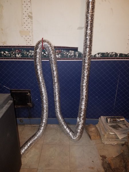

    Here's a shot of the cold air trap I made for the OAK...
    It ain't pretty but it's a basement install so I'm not overly concerned with looks. Someday I may prettify it with some rigid pipe.

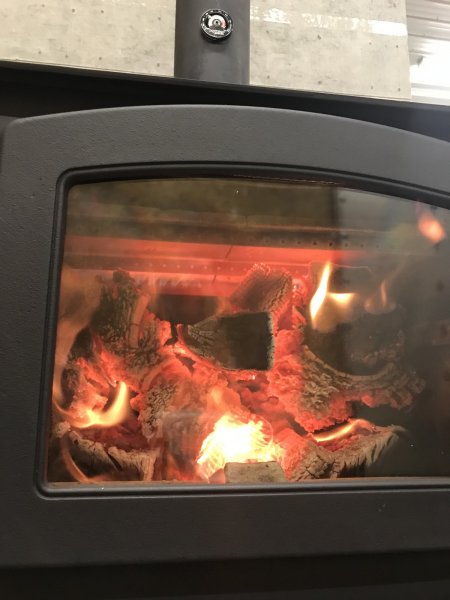

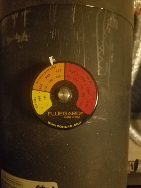

    Question on this probe thermometer...
    How accurate are these? It hasn't been getting quite as high since I'm cutting the air earlier with dry wood but it is still a bit puzzling sometimes. This pic was taken about 45 minutes in to a small load with a STT of 525*. It peaked at 900* and a STT of 625*. I am wondering if it is reading high or is that normal?

    They are pretty accurate. Your numbers sound reasonable.

    If I do not get at the air control quickly with a new or reload of "dry" fuel ( Red Oak Mulberry Ash and Elm mixed loads) stt in the 750 range is what I will see. That is one raging inferno. Closing the air control and it will settle back to the 6 hundreds. I let it selltle back and then re-open the air control to apx the ash lip - that is mostly good until I get back home- there will still be coals for a relight. Pretty much keep the propane back up off for apx 12 hours. It is set at 68F. Did a top down light off this morning - had cleaned out stove prior. Kind of impressive, stove was 98 % red oak and a couple of small mulberry sticks to fill some gaps. will see whats left in a couple hours. First time I ever tried a top down light off.
