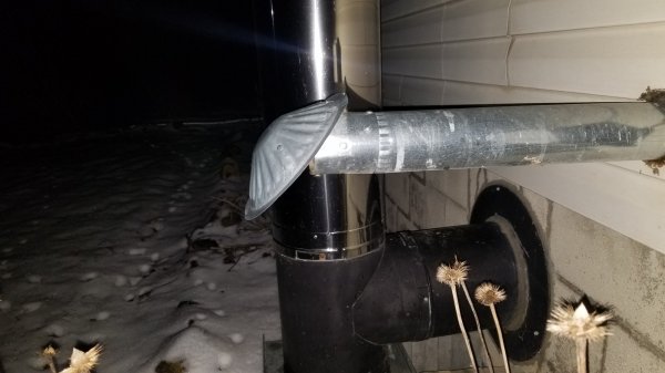

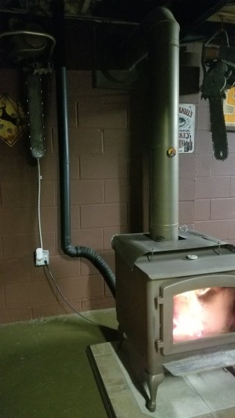

    This is inside. I'll go outside once I put my daughter to bed.
    Standard 3" rigid venting from outside to inside, then some 3" flex vent to the woodstove.

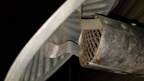

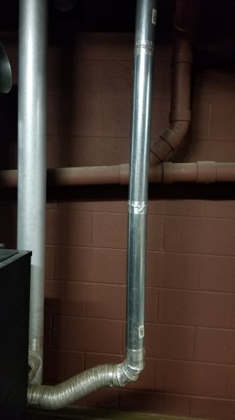

    These first 2 pics are the woodstove OAK. We went a couple feet off of the house with it (3" gas vent cap bent on an angle).
    When I did the pellet furnace OAK. I did more of a flush mount, but kept the same type of cap (bent on an angle). The pellet furnace OAK is the same material (3" rigid to 3" flex) but I have not painted it black yet.
    The only advantage to painting it, is when it's below 20° outside the pellet furnace OAK sweats a lot. But the black pipe has never had a drop of condensation.

    For a longish run like that I would be tempted to run 4" pipe, adapting to 3" before the flex. But apparently the 3" works fine.

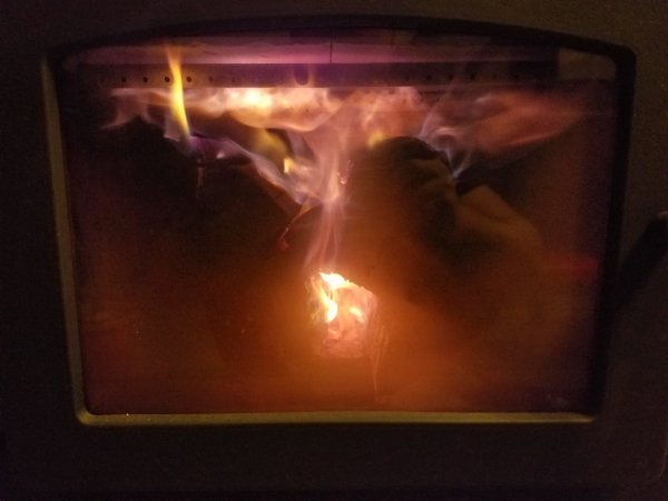

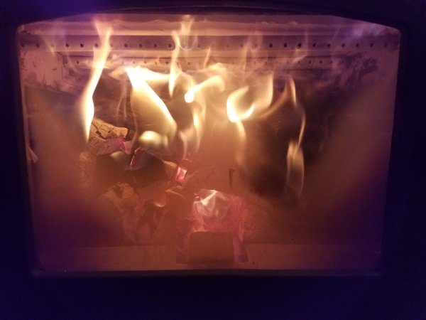

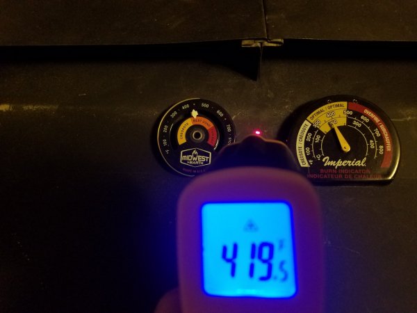

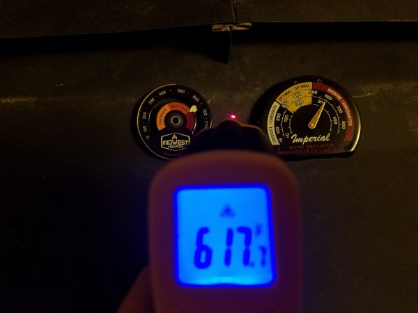

    I am trying the 'backward' fire as the first fire of the day. When I got to the stove this morning the STT was around 200* with the fan on. There was a decent amount of coals but to be sure it would light well i threw some kindling on top of them before loading. I did just as bushpilot said, I pushed the coals to the back, tossed on some kindling, loaded up and closed the door.
    These pics were taken within 15 minutes of loading. I had secondary flames within 3 minutes. I couldn't believe how quickly this lit off and the stove came up to temp. Keep in mind this is with less than ideal wood (some in the 18% range, some in the 22-25% range). I did leave a pretty good sized tunnel for doghouse air flow to the back of the stove. Now it is a waiting game to see how long this load lasts. Initially I am impressed :)

    If you keep the doghouse tunnel smaller, you can slow the speed of the primary flames propagation towards the front, and extend the burn. If you get it all right, it will give you about the longest clean burn you can get from this stove.

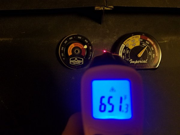

    Just checked to see how it was going. It has been about an hour and a half since loading this morning.
    After initially spiking to about 625* STT after light up, the temp settled and hung around 575* STT for about an hour. It apparently has kicked in to another gear in the last 20 minutes or so. I'll check again in an hour or 2.

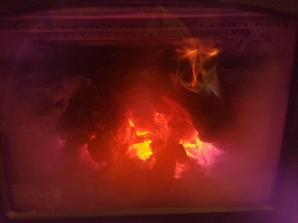

    Final check on the 'backward' fire...
    3 1/2 hrs after loading
    I thought the STT would hold higher than that by this point. However, I do have the air set lower than I normally do because of the sunshine outside (house currently at 77*). The other thing I noticed was some coals that had fallen in front of the doghouse. All in all I kinda like this method of burning. Now we will just have to see how long it goes. I will put it to a real test tonight for the overnight burn.

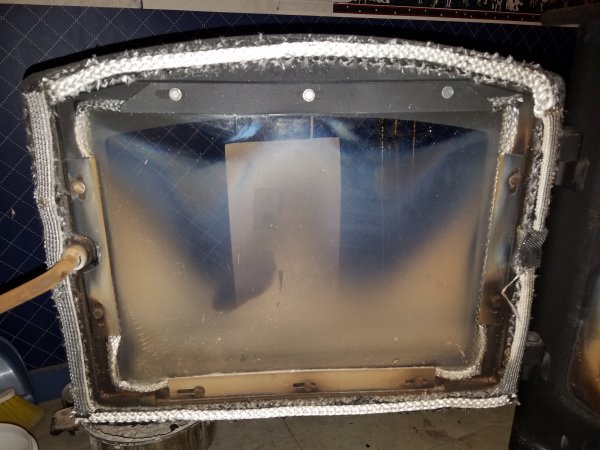

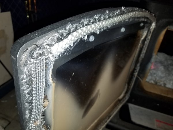

    Last night I had a eureka moment. I've been trying to delay ordering a new door gasket until after the burning season ends. I remembered last night I still had a bunch of pieces of gasket leftover from the osburn.
    I had been 'fluffing' the door gasket on the 30nc for a few weeks now. Last night I smeared some cement on the gasket and stuck pieces from the osburn gaskets on top of the 30 gasket. Worked like a charm. This should get me through until spring shows.
