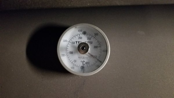

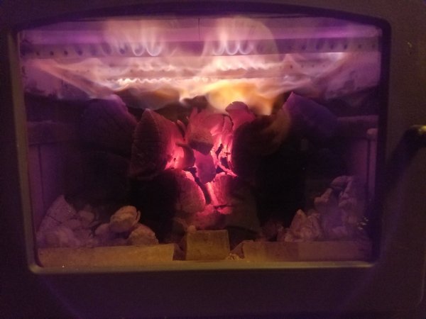

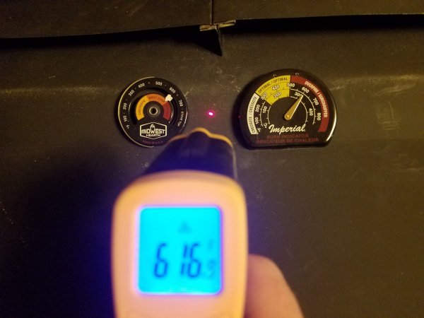

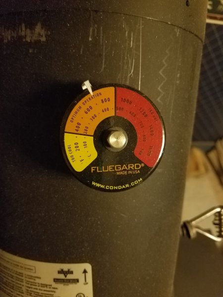

  20. Marvin
    Marvin
    Mar 31, 2018
    2,268
    15,302
    Huntingdon, Pa
    I think I'm finally getting a feel for this thing now. I understand the doghouse air and secondary air is not controlled. What I was trying to explain was that I was leaving the primary open just enough to keep an active flame in the "tunnel" from the doghouse. The last 2 loads I have focused only on secondary flames. I have been turning down the air as far as possible while keeping secondary flames. This seems to work much much gooder :thumbs: I will find out in the morning how well it holds the temps in the house.
    Here is the overnight load about 1 1/2 hours in to it...oak and ash
    Stove Top Temp holding around 620* with the blower running on low
    Flue temp staying well under control, only thing coming out of the cap looked like steam when I checked
    I hope this is finally starting to click for me. I cannot thank every one of you enough for your patience with me. I know I've asked a lot of questions and you have all been so gracious with your knowledge.
    We'll see what it looks like in the morning :yes:
