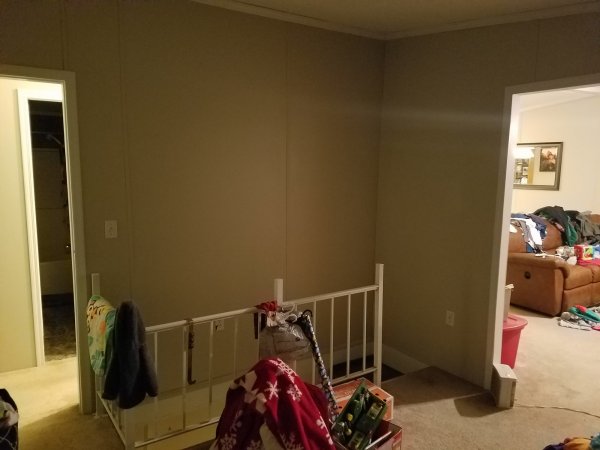

    This is what it looks like at the top of the steps. Not too bad. Eventually I would like to put some vents above the doorway and entryway on each side of the room.
    Don't mind the mess....

    That sounds like a good idea. I bet there's a ton of heat just hanging out up near the ceiling not able to move around. I think stratification is the word, but I just call it hot air stuck up there.:thumbs:

    Mess! What mess? I see toys...and toys mean youngsters...and youngsters means lots of love and fun...and that means living! Nothing wrong with living either, by the way...ling well. LOL!

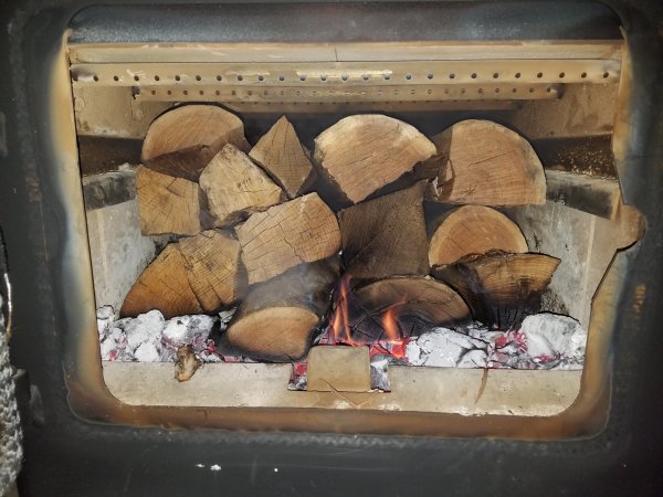

    Hoytman this load weighed in at approximately 42 pounds. It was a mix of ash and elm. The long one on the very bottom just to the left of the doghouse was probably 20 inches long if I had to guess.

    How long? 18 1/2” is ideal. Up to like 20 is doable. Now the NC-13 is the little brother to the N-30. You can get by with like a 18” cut I believe, but that East/West. 12 something for North/south. Personally that the best way, keeps the rollers from rest against the glass.
    House Size wise: I ran the NC-13 for like 3 years... and now on about 4 years on the 30. The 13 was on its upper limits, 1 to 2 am wake up to start a fire got kinda of old, and work .... cause 8 hours work days are pretty nonexistent... I’d get 6 to 8 hours of useable heat from it. Where I get 10 to 14 hours on the 30. Plus, the 13 was good down to about 15 F to 20 F, where as the 30 I’m good down to 0 to 10. But on light days it’s almost too much. The best way I found to control the heat output, is too load with lesser BTU’s firewood. It simply likes to run. Both stoves do like to stretch there legs and run. Just using the fan, especially at the end of the burn cycle will still be throwing off heat.
