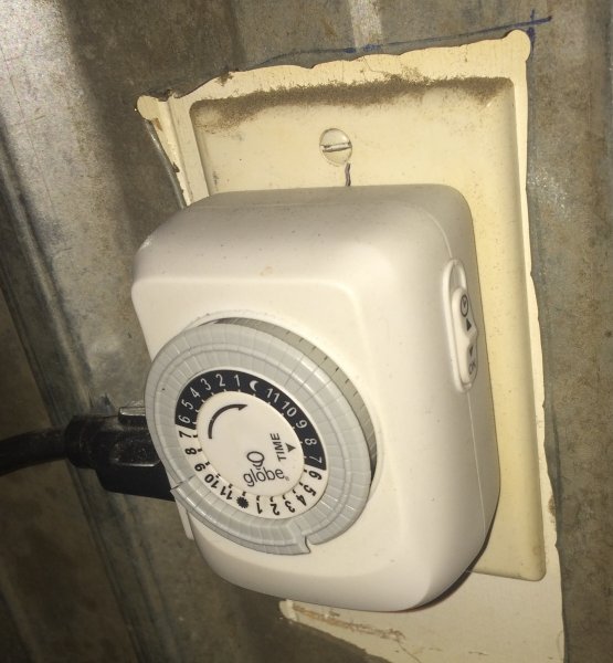

    Question about the ac30 blower...do you all have one? It seems pretty much every nc30 owner I've seen comment recommends it. For those of you that have it, how do you run it? Do you have a switch set up to kick it on at a certain temp?
    I have the blower that came with it. I thought I would wait until next year to upgrade but right now I seem to be constantly running back and forth turning the blower on or off depending on STT. This is a problem when I'm gone all day for work and overnight burns. It would be nice if it had an even lower setting so it wouldn't cool the stove top so fast after peak burn.

    image.jpg You could get a basic outdoor timer such as this.

    Interesting....I never thought of that. So do you just set it for a time then? I guess if you have your routine down well enough that would work just fine.

    It has a bypass so you can run it when you're around and just turn off the blower when you want as you normally do. I only use the timer for going to bed or gone in the daytime. Just set it depending on the load. It doesn't matter if it runs even once the stove is petering out, as it keeps the convection loop going somewhat. They don't cost very much either, $12-$15 should get you a basic timer.

    I don't think there is any "harm" in letting the blower run when the STT drops, it doesn't affect the burn, really it's only a waste of the electricity.

    I'm trying something new as saskwoodburner suggested and have the blower set on a timer that I had for Christmas lights. I have it set up to run on low in roughly 30 minute on/off increments. We'll see how that does pushing heat upstairs.

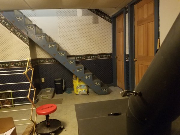

    That's an interesting way to go about pulling the heat out, curious how it'll work for you. Dumb question, but what kind of ceiling run do you have going up the stairs before it hits the door way? Could you take a pic of how it looks? I may have the silliest way to help move air a little bit easier.

    I'll take a pic later. The ceiling runs about 10 feet (drop ceiling) until it gets to the stairs which are open.

    Here are a few pics of the stove room. As you can see the stairway is pretty open up the steps.
    From behind the stove...
    From the side...
