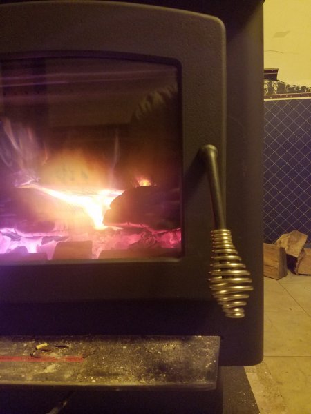

    I started closing it tighter. That has helped quite a bit with keeping the glass clean. I can still pull a piece of paper out but it has quite a bit of resistance now when I close it that tight.
    Here's a pic of the handle position closed tighter...

    Perfect

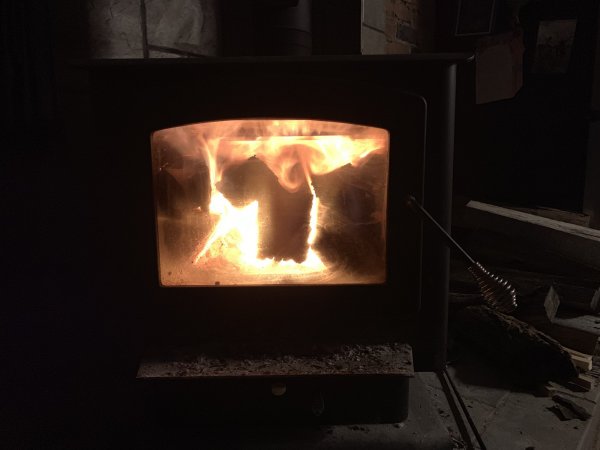

    Wow... I think I’m at 4ish on mine... I’ll look in the morning.

    3 or so years in, mine is at 4-5 o'clock position. Haven't changed the gasket yet. I think new it sat at about 3-4 o'clock.

    Here’s mine.... this is 6 years in March. Plus most of the time I push the latch down with my foot, so I don’t have to bend down.. this also goes with the push rod.
