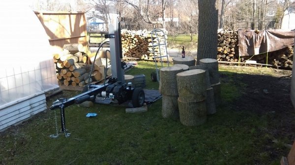

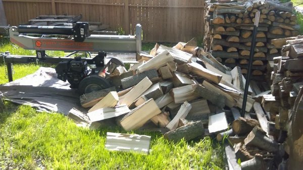

    I like mine:thumbs: I had some issues with the motor but that was resolved and it is a champ fired up and splits relatively fast.
    I run ethenal free summer blend 87 octane if I remember correctly . I'll fill up 4 cans for the splitter and that's lasts me the winter.
    As for hitting the motor I've not had an issue yet. Honestly it's designed very well.
    I WONT EVER pull it behind a car again though EVER! I can't believe it didn't rattle to pieces coming home.. Now it gets loaded in a trailer if it goes anywhere.....

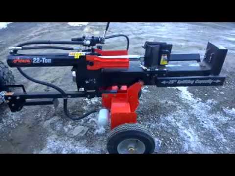

    You could hit the engine, but the engine is further forward than where splits would normally fall. Granted, if one gets hung up and retracts with the ram, it could release near the engine. I think the log cradle is almost a necessity though or you'll be doing a lot of picking up splits. The log cradle bolts to the engine side.
    My only other experience was with a Gravely 27 ton (same as the Ariens) and that had wider rails that could catch falling splits a little bit...not as good as a log table/cradle though. The part where it says Splitting Capacity are rails and are wider than the DHT top and allowed halves/splits to stay off the ground.

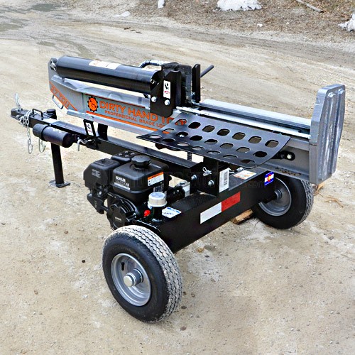

    EDIT: Looks like they have a larger flat log table available too. The large table looks like it totally covers the engine: Large Flat Log Table Kit (Excludes 22 Ton Model 106080)

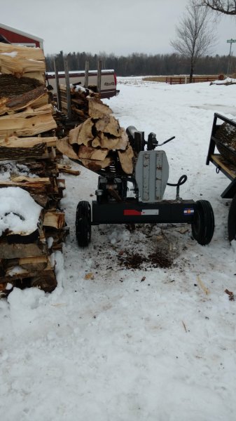

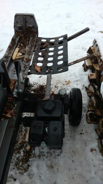

    Something simple as a couple angles welded on works great, these at 12" they could be 18" to hold even more

    I also welded the grate in place because it kept creeping down letting pieces roll off, extremely glad I extended it, when splitting by myself I can load a lot more on the splitter from the trailer.

    Sweet shaggy wood dump hoarder , thats what I'm talking about-I love my splitter but I'm tired of half a 8" split not resting left or right while I handle the other half---def gonna have to fabricate or alter something...your set up is what I'm looking for-TY

    Thanks for the replies answering my question. I can see where that larger table certainly work well, and I'll take you guy's word that hitting the engine just isn't a problem.
