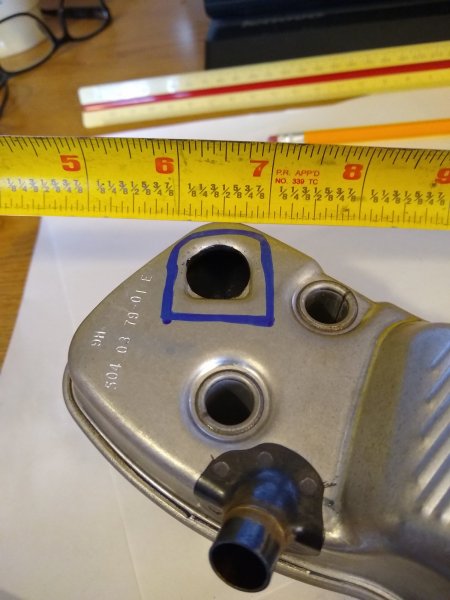

    Of course I already removed the muffler and opened it up. I pulled the muffler off of it before I even put gas in it just to see what I could do with it. Once I figured out what I could do I put it back together, put gas in it and fired it up. Once everything checked out I pulled the muffler back off and started drilling. LOL I left the OEM hole alone and just added a much larger hole where the US version would have had one. I also poked the same size hole in the baffle plate right under the hole I put in the muffler, this allows the gasses to be able to go right from the cylinder to the outlet I made instead of going down and through a hole in the baffle plate located near the bottom of the muffler and then out either of the two exit holes. I brought it over to the welder I know and he created and welded on a deflector over the hole I put in it. I was then able to tune it (richened up both low and high sides). Now it's running the way it should be! :) The US version of the muffler has the outlet exactly where I drilled the hole. So I just basically added a larger US version outlet in addition to the overseas version. It's a bit louder, but not bad at all.
    Stock US muffler (photo I found online):
    Hole I put in my muffler:

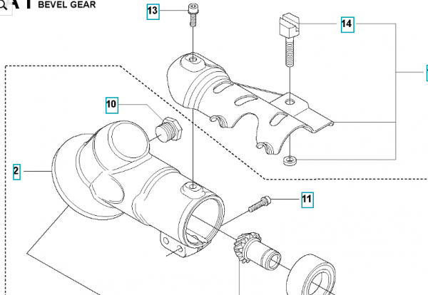

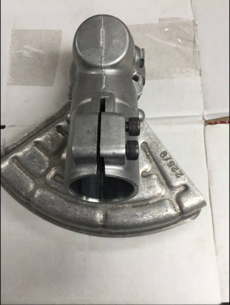

    On my saw they actually use completely different heads. :(
    The saw blade uses this head (which is the one I bought new on eBay and is for the 555FX so I could safely use the saw blade):
    The triangle and trimmer use this one (which is the one which comes on the 555RXT). This one allows for the mounting of the proper shields for either the trimmer head or the triangle, but not the shield for the saw blade.

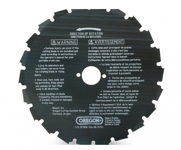

    Which reminds me. What blade do you use on yours? I bought the MAXI style. I was told they are better than the EIA style. This what that Swamp Donkey fellow said, and he uses them for a living.
    This is the MAXI style and is supposed to work better:
    This is the EIA style:

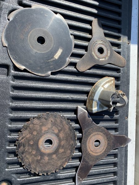

    It is just different guards, not heads, for mine. Looks like my triangle is the 300mm, and the blade is the EIA style.
    The old Stihl saw blades on top, and the bigger Husky’s blades at the bottom. I wasn’t aware of the Maxi style blade. I’ll have to look into that. It would shine out in the woods cutting striped maple and beech.

    Here's where I ordered my 9" MAXI blades from. I believe this is the one you need for yours....8".
    Blade, Brush Cutter, MAXI, 22-Tooth
    The EIA ones also seem to be known as "Scarlett".
