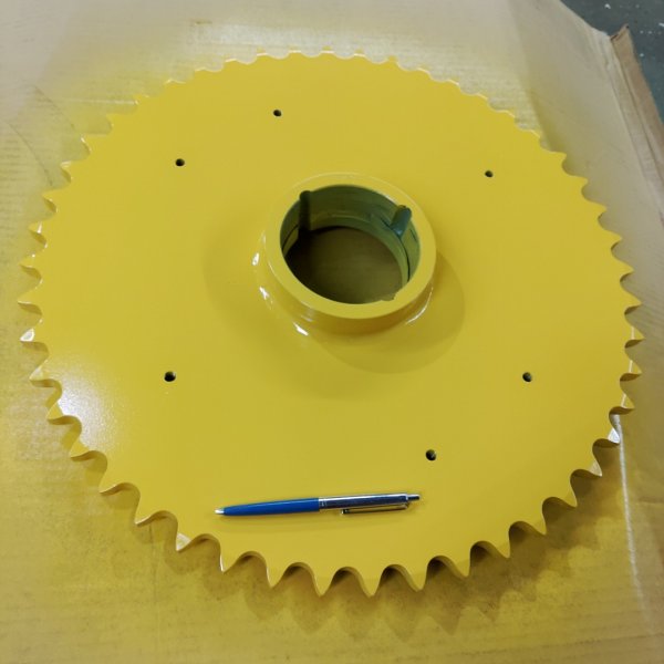

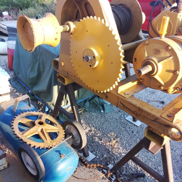

    Calculations said that it would be too fast for my clumsy azz so I found a rusty NOS sprocket on eBay.
    A little blasting and a bit of yellow and it's good to go. IMG_20220911_153055_(1080_x_1080_pixel).jpg

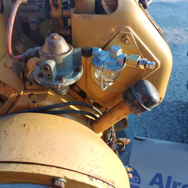

    Got the driven sprockets swapped. Still have to bore and broach the drive. IMG_20220916_182739_(1080_x_1080_pixel).jpg
    Changed out sediment bowls and installed the Chrysler connector. IMG_20220916_182758_(1080_x_1080_pixel).jpg

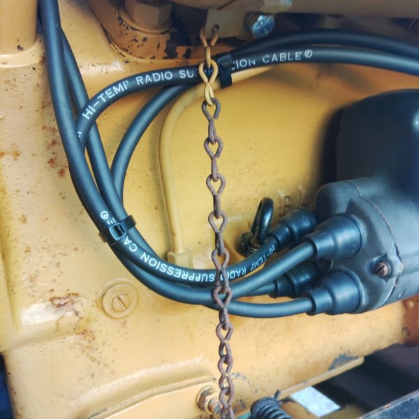

    Got the old pipe out and a nos nelson muffler with cap in.
    Time to make up the new wires and swap plugs.

    You should NEVER see these words on Wisconsin wires!!!!
    Or on any magneto !

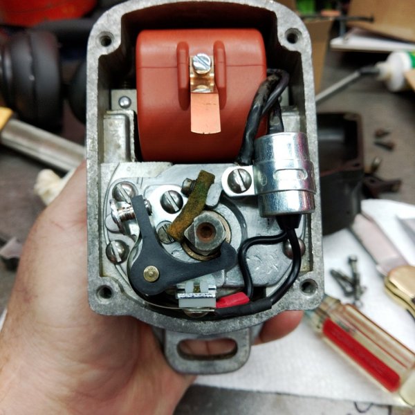

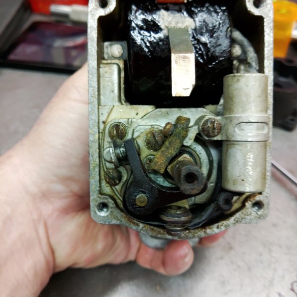

  12. Screwloose
    Screwloose
    Jan 15, 2017
    5,699
    33,843
    Points.
    Fairbanks morse model J magneto.

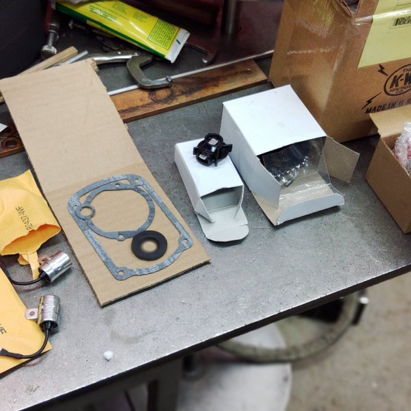

    Coil has leached a lot of tar, didn't even get the meter out.
    Some azzwipe drilled weep holes in both caps......the caps whose gaskets are supposed to be coated in shellac making it air tight.
    Unless the weep holes were intended for mud wasps, and in those regards they worked fine.

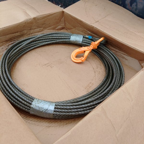

    Got my magneto parts. Notice anything &#@%ing wrong!!
    200' of the slimiest cable I've seen. I think it was dipped. IMG_20220924_161809_(1080_x_1080_pixel).jpg

    Before, (check out the screws!)
    And after $150 and 3hrs of work.

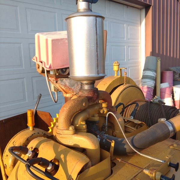

    So last night I tried for a while to start it and only got some puffs and burps.
    This morning I wanted to check the timing and since the flywheel screen was off I pulled it around by one of the vanes.
    Mag clicked and it took off running and almost took my finger with it!!
    It's been running around 9 hrs non stop now. Running better and better.
