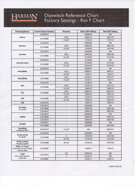

    Here are the settings for the dips for the PF100
    Control board # 3-20-05376
    All Switches off BLACK ESP
    _________________________________________________________
    Control board # 3-20-05888X (X being a letter A B C D OR ??? =REVISION #
    Revision A control board Switches 1 off 2 on 345 off 6 on 78 off BLACK ESP
    Revision A control board Switches 1 off 2 on 34 off 5 on 6 on 78 off RED ESP
    Revisions B AND UP Switches 1 on 2 off 3 on 45 off 6 on 78 off BLACK ESP
    Revisions B AND UP Switches 1 on 2 off 3 on 4 off 56 on 78 off RED ESP
    This is what I was able to glean off of the Harmon factory chart

    Your board is the 3-20-05376
    Chart shows all dips off BLACK ESP ONLY WITH THIS BOARD
    The 05376 and the 05888 boards seem to be interchangeable EXCEPT the 05888 will allow the use of ether black or red ESP
    This setup uses a 6 rpm feed motor (Check yours to be sure its correct)
    I am not versed on the Harmons, but the info available from Harmon is pretty good as far as the details go

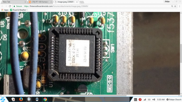

    good advice from Snowy Rivers, but to get the true correct settings, you need to know the circuitboard REVISION. Look at the label on the board and check out which letter follows 3-20-05376 or 3-20-05888. This is important as dipswitch settings can change with revision!

    The chart I dug up from Harmon did not mention any differences in the -05376 board
    due to revisions...the revision box had a line through it.
    The -05888 board has revisions A and then B and up.... as I mentioned in the post.
    Pelletmans picture shows a -05376B board
    There are no mentions of different settings due to board revisions in this part number.
    Here is the blow up of Pelletmans label on his board

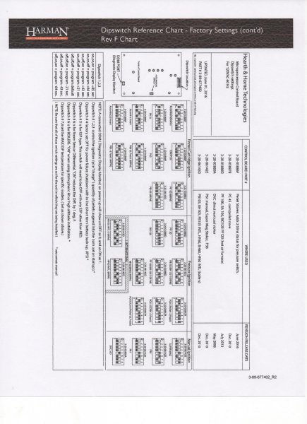

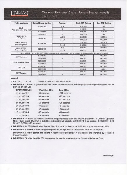

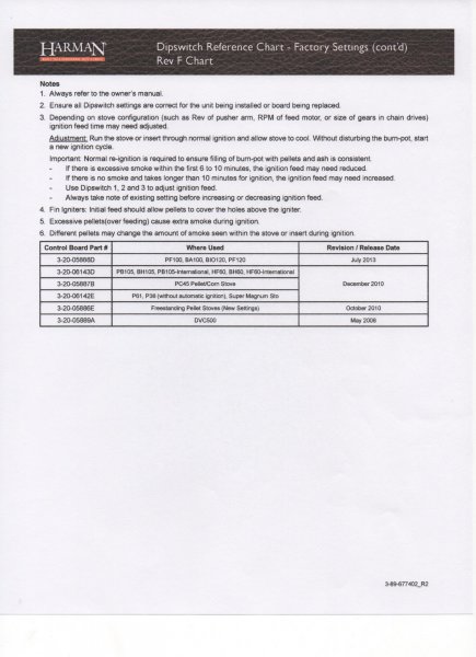

    After doing more snooping I have come to the conclusion that the -05888 board replaces several older boards...including the -03100, 05376.
    The -05888 seems to be the "Good chit" latest incarnation.
    If it were me I would set the board to the dip settings that were listed for your board and see what it does.
    Here is the full download I got on the Harmon stoves.... Looks like a lot of great info for anyone with a Harmon appliance. PRINT THESE AND STICK THEM WITH YOUR STOVE PAPERWORK.....
