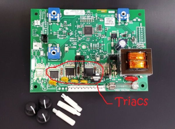

    I’d say you are exactly right. When I got this furnace he had a timer on it for the fuel auger, and I belieave it was wired wrong. Can I replace the triac on the board? Or does this mean I need a new board?

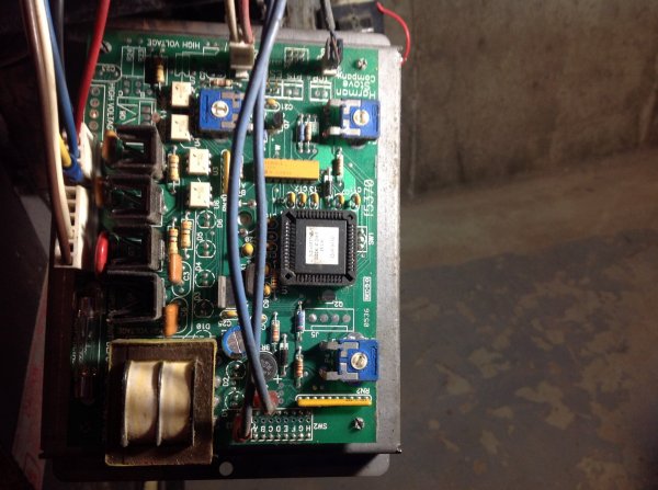

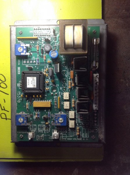

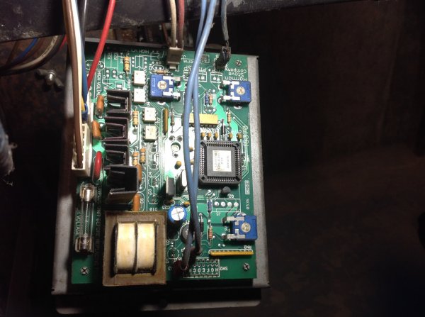

    Members have replaced them in the past....I'm guessing it depends on how fried the actual board and traces are.
    Maybe Snowy Rivers or jtakeman can chime in. Pics of the board will probably help them a lot, to help you out.

    If you can solder and see the part number off the triac. They are easy to replace.
    Things you will need:
    40 watt soldering iron - Fine tip
    Solder wick to absorb the old solder of the triac.
    Thin solder for electronics.
    A nice flat surface with plenty of light and a loop/magnifying glass. You will need to trace out the circuit to see which is the igniter triac.

  6. Snowy Rivers
    Snowy Rivers
    Nov 15, 2015
    2,854
    12,510
    Newberg, Oregon
    If someone has messed with it there was likely an issue.
    The timer on the auger sounds like a work around to get things operating.
    Here is a link to the manual on the PF100 http://downloads.hearthnhome.com/installManuals/PF100.pdf
    Also a piccy of the board...
    What needs to happen is to look at the schematic (In the manual) and check out all the various components to be sure all the wiring is as it should be.
    Note....
    The manufacture is not going to show the board schematic and what components they used.
    Be sure that the 120 volt outlet is wired correctly BLACK WIRE TO L1 and the White to the Neutral and green or bare to the ground prong.
    Use your VOM to be sure that the leads are phased correctly too.
    Set VOM to AC voltage scale (High enough to check the 120 volt) check between the WHITE wire and the ground READING SHOULD BE 0
    Check between the White and the black wires....reading should be between 115 and 120 volts
    If the L1 and the Neutral have been switched it can foul up the controls.
    If things check out then it sounds like the control board is HINKY.
    Everything that happens has it's origins at the board.
    As mentioned..."Possibly the triac has gone south" there are probably more than one on the board..... There is likely a logic chip on the board as well.

    The triac being shot will normally not be evident on visually inspecting the board, and operation would depend on what position the triac was killed in. Often see the triac stuck where the igniter never goes off......a wire might get pinched, or insulation might get burned off, etc. If the stove was in an ignition cycle when it died, the triac will keep the igniter on.

    So here is the update. I am actually a millwright in a mill. So I asked my co-worker who is a good electrician to have a look at the board. In two seconds he says the large Triac is gone. Perfect I say, now can you fix it. And the answer "NO". I do not have the tools and I cannot test it. I asked him, "how do you know". The electrician says you can see where it heated and cracked. And sure enough you can see the crack in it. But he gives me a name and sends me on my way. So i take it to the electronics shop he recomends and he says 60$. But he tells me there is actually 2 Triacs that need replacing after testing. Future more, he says he fixes them all the time. So i asked both electricians why? the triacs failed. Both gave the same answer- the Triacs are both on the high voltage side(120 volt) in this case. There are only a few things on the high side- combustion fan, air fan, igniter and auger motor. Furthermore they both said most likely igniter over heated, next the auger, last would be the fans. Both also said to do just a simple load check when I start the furnace again. So thanks for the very good info. I will try again soon, and let you know.

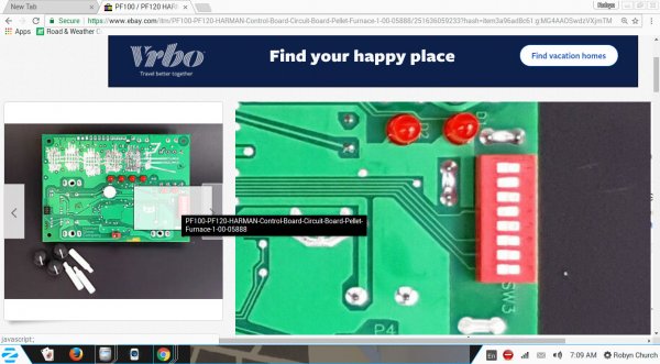

    How would i know if my board should take a red ESP or a black ESP. The electronics man said the board I have is not that old. And I'm looking to make sure I have everything as correct as possible.

    it probably can take either one, you just have to change switch settings if you change colors of ESP

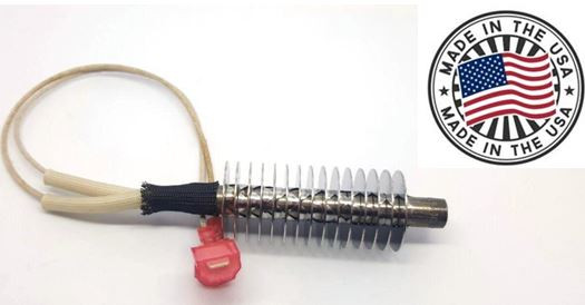

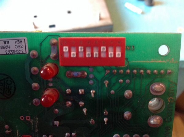

    I scoped out a DIP SWITCH CHART for the PF100
    SETTINGS ARE (Finned cartridge ignition)
    #5 ON RED wire
    1234678 OFF
    The two types of igniters
    The slim tube type is the pressure igniter and the one with the fins is the finned cartridge
    You should be able to identify what you have and where to set things so it will work right.
    Make a note of your dip switch settings (Current) and check against whats recommended
    Note the piccy of the dip switches All marked 1 to 8

    K, so my dips are not correct. I have a black wire to my ESP. I have a finned igniter.
    So, should all my dips be on "0ff"?
