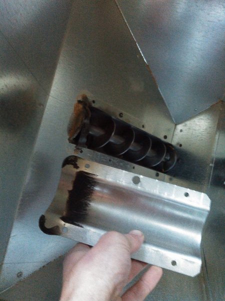

    It had rtv on the cover originally do I need that again? 1414327492072-1036565365.jpg
  5. jtakeman
    12,303
    55,447
    If it had some originally? I would re-seal it. I think they use it to reduce smoke in the hopper on start ups(FYI). Notice the black on the upper portion of the cover.

    I'd reseal it as well..
    The old vacuum line... :D Happens to the best of us bro!

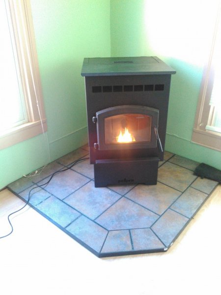

    Woot I just need to cool it down and high temp caulk it all up. The wife loves it lol..... Thanks for all the help you pellet guys! KIMG0249.jpg

    Wow thats definatly got the heat output to do the job...........
