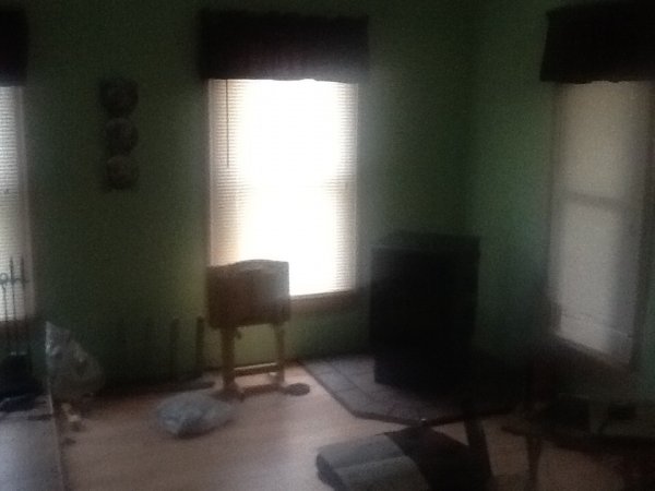

    Ok I just got off the phone with pelpro. They have great service by the way! Any whoo no I can not go up inside and out it has to be straight out then up. That is fine I can move a hole later and seal the old one. At least I can go up.... Now the issue is distance to a window. The manual states
    1) not less than 48" below
    2) not less than 48" horizantal
    3) not less than 12" above.
    Or not less than 12" below, horizontal or above a permanently sealed window.
    If this means what I think this means I can't install anyways... I havnt got 4' between windows anywhere in my lower floor dining room or living room.

    Pete, As I understand you, you will go out and up. If you go 12 or more inches above the window, are all set. If you had a window the left or right of the vent opening within 48 incher, or if it was under a window within 48 inches then that would fail unless it was a non opening window. In the case it is 12 inches. I seen folks just screw the sashes together to get an non opening window.
    If you are 12 inches above the windows, you should be all set. Call them back. show them what you plan, get endorsed.

    So that's not the point where it goes through the wall it's the point where the flue terminates? Where the exhaust exits that has to be 48 or 12"? If so PRAISE THE LORD! I can install!

    Yep. The vent can be one foot above the window. Your vent can run right up the side of the house, then once you are 12" or more above the window, use a 90, then put a cap on it.

    Just double checking lol.. I could put the thimble right next to the window in the wall as long as the exhaust exits the chimney 12" or 48" away from the window?

    Run it by the powers to be, the company and the inspector before you cut. But it is the where the vent dumps that is the issue. The pipe itself has to be a certain distance from a combustible surface. Fax a penciled drawing or a marked up photo to the company and see if they fax an answer back. Then you can show the installer that your complied.

    Pete, the vent has to be 12" above the window. It also has to protrude a foot away from the house. But it has to be 1 foot above.
    Go above the window line, then put on a 90° and the cap. Bingo..

    STOP! Hope you have not cut any holes.Go to pelpro website and the install video shows installing up and out,for that stove!
