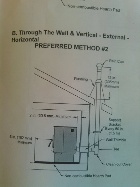

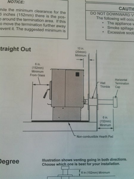

    DexterDay jtakeman so I asked today about running up the wall inside the house and as told if its in the manual... It isnt. The only three options I have are straight out or straight out and up. I am ok going straight out but up could get really messy with my roof line. He said it needs to be exactly how the manual shows it.

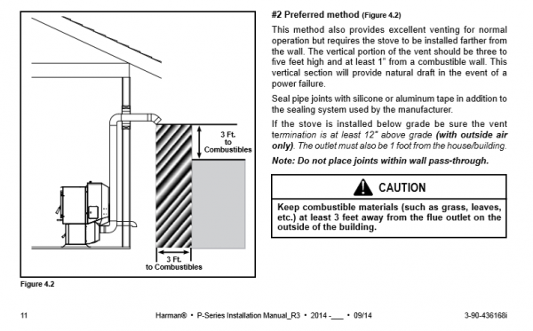

    Need another inspector,or spend more time with him.Manual says "preferred", not has to be.On another page in manual shows going up then out through wall and into outside chimney,same thing.Now you know why I dislike peolpe(inspectors) that do not take the time to learn their job.Problem with 2 90's is you need to go to 4" pipe.(maybe you have as I did not read all the posts).Up and out generally leads to a cleaner pipe inside.

    I agree. That inspector is clueless. .
    Preferred does not mean Mandatory.
    Going straight up would be the best for the stove (would have the lowest EVL) but is the hardest to install.
    This is the easiest and my "preferred"way. Up and out.. :dex:

    There isn't another inspector the last guy got in trouble and this is the only other one... Unfortunately it's his way or the highway.... He's a lot better than the last idiot at least... The issue now is that it's only going to be approved if I follow one of the provided pictures from the manufacturer and no other way. I really can't go up through the soffit outside without a big expense and the roof isn't gonna happen. I hate to say this but I might just have to give up and sell the stove. The BS involved is really starting to tick me off........
  18. DexterDay
    DexterDay Administrator
    12,411
    31,636
    Northeast Oh
    Every other Manufacturer has the up and out listed because it's a "safer" install. The vent doesn't get as dirty/ashy, because the vent is warmer.

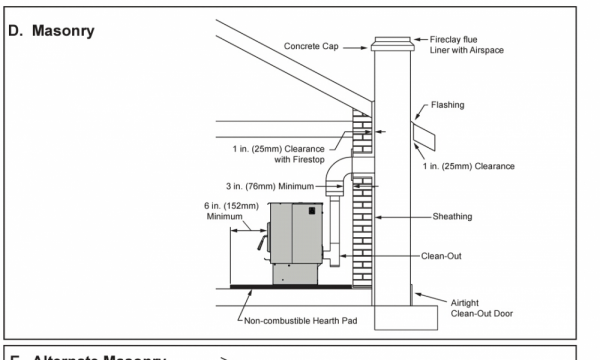

    The Masonry install is exactly what you want to do.. Minus the Masonry. ;)
    There is no other spot to install it? I wouldn't sell it. Unless you buy any other stove. Because any other manual has the up and out listed.
    Pallet Pete likes this.
  19. Pallet Pete
    Pallet Pete Moderator
    13,479
    54,102
    Ovid
    That's what I asked him! Lol he said only if it's masonry. Yes I have that pic. He said if I installed that way then I'd have to tear it all out and start over. According to him it's law to follow the manual to the T. I'm not being stubborn I have my hands tied.......
