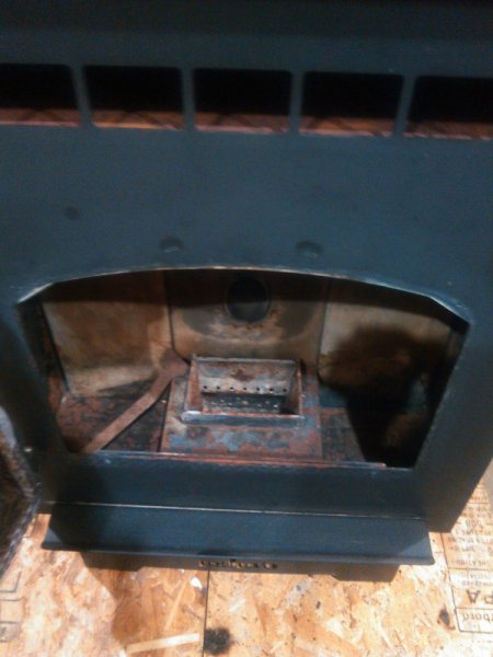

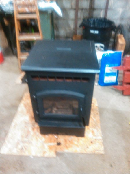

    Its in good shape except for some minor surface rust that I need to fix. It was left in the garage this year and did rust a little. Overall its an easy cleanup! I fired it and let it go for a little while and it worked great no issues at all! I can't wait to hook it up…. DexterDay Is the light rust something usual in the burn pot or is that just due to setting in the garage? I checked all the info and it was built 12/22/13 and sold 2/17/2014.

    For $400 clams, I think you did rather well.
    Once the heat gets to the metals, Any moisture contact will result in rusty spots. Being in the garage certainly didn't help matters!

    Thanks bro! It all literally wipes off the stove too I just hit it lightly with a wire brush and BAM no more rust.:D

    The rust on the inside is not a big deal. The rust on the outside can be cured with some Stove Bright Satin black paint.
    The big thing with a pellet stove is the fuel to air ratio. You want to make sure the burn pot is seated properly and all gaskets are good and seal tight. If there is a big gap in the burn pot and burn pot receptacle, you lose some air that would normally be used for combustion. So make sure the pot is in correctly and there is no big gaps.

    it really looks pretty good.....its metal, can be cleaned up, very easily in this case.......I think ya did well......

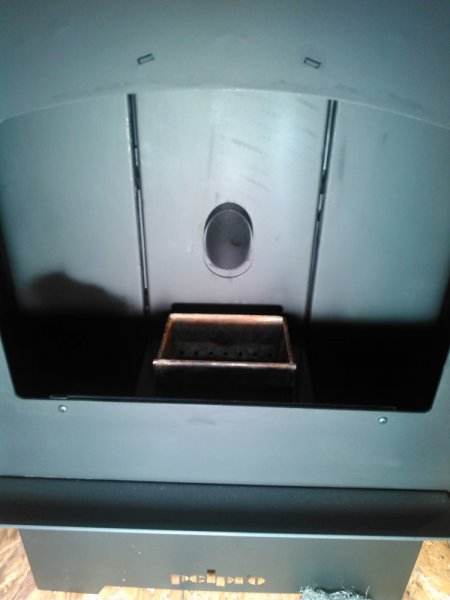

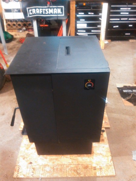

    Getting the stove cleaned up!

    Thanks! I bought a bunch of 2" air grinder stripping wheels from HF and cleaned everything I could then hit it with 1200 paint from Menards. While we where there we noticed they sell this stove! $995 for our model and it's rated up to 1650sq ft on the sale tag... Our downstairs is 1000 sq ft. Wonder if it will do better than we thought? I can't wait to see... The manual says 1750sq ft soooo.
