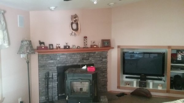

  2. Well Seasoned
    83,789
    Would a SS liner be suggested for my setup?
  3. Lousyweather
    Lousyweather
    Dec 23, 2013
    2,798
    9,040
    I would liner the thing, yea.....put a tee on the bottom for a clean out, fix that $%^&$ connection on the stove while you're at it.....just throw out all that crappy pipe you have and buy some nice ICC pipe.....they even make a liner adapter!

  4. will711
    will711
    10,270
    50,828
    Pocono Mts.
    those left over parts are from a thru the wall set up , makes me wonder if the stove was in a different location in the house or a Craig's list purchase that came with the pipe

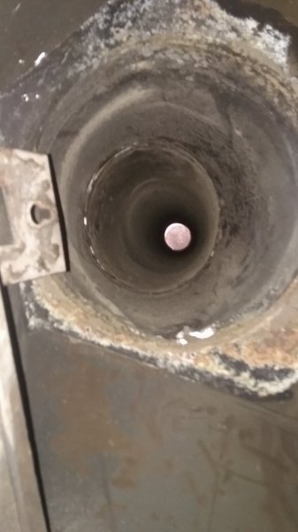

  7. Well Seasoned
    83,789
    Here's a picture from inside the fireplace, up. The pipe is more like an oval than a circle, it's straight though. Doesn't seem to be any issues other than some corrosion where it meets the fireplace box. Eventually a wood stove will be here, so I need to think ahead.....
    slvrblkk likes this.
  8. ttdberg
    ttdberg Pellet Pig
    Apr 3, 2014
    3,596
    16,002
    CT

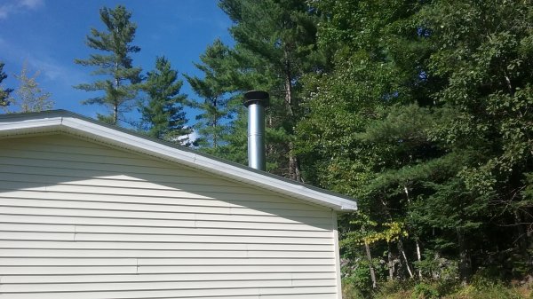

    Is the fireplace flue on an outside wall?
    slvrblkk, Well Seasoned and will711 like this.
  9. Well Seasoned
    83,789
    Yes, square room, plastered corner for the fireplace unit, out through roof.

  11. Well Seasoned
    83,789
    I decided to do a complete tear down of the existing venting along with all the other venting I had here. Upon a thorough inspection of the goods, dbl wall venting looks good, gasket was good, and everything twisted and locked together nicely. I managed to add another 5' of pipe. Tomorrow I will work on the connection to the stove. This upcoming season will be the only time the pellet stove sees use until it's moved to another room for next year, when I'll get all new chit to vent.
