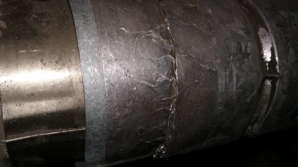

    Sweet! I was hoping you would say that. That is the safest route and easiest to clean!
  3. imacman
    imacman
    Oct 23, 2013
    6,630
    27,517
    Denver, NC
    I could be wrong, but it doesn't look like an appliance adapter is being used to connect the exhaust to the stove.......unless that's a brand I've never seen before. Any idea what is physically holding the pipe to the stove exhaust?? Any signs of Hi Temp silicone?
    Well Seasoned, CleanFire and slvrblkk like this.
  4. SmokeyTheBear
    SmokeyTheBear
    8,308
    39,367
    Standish, ME
    Done properly there s/b 3 self taping screws don't see them Pete you have pics. for a guide? exh systems aren't places to play games.

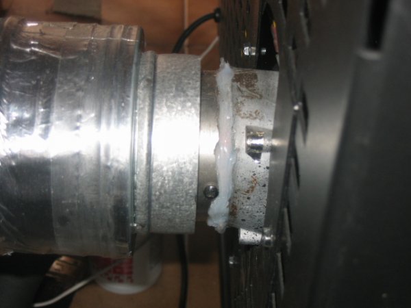

    Don't know what brand of exhaust he has there, but this is what my Dura-Vent Pro looked like:

    Metal Fab pipe maybe? It's not Duravent, ICC.....no matter. Not liking the connection, as I don't see a mechanical means of connection, but the picture isn't THAT great either.
    Does the pipe change over to stainless steel liner above the block off? Not a fan of galvie pipe in contact with masonry, especially in an area you cannot readily inspect. Galvanized pipe can rot given sufficient contact with moisture and chemicals in masonry (lime, tricalcium aluminate, etc).....if it's pipe all the way up, would also be concerned with the pipe joints themselves. Don't assume that since its there, it must be ok.....but I think you're smarter than that anyhow

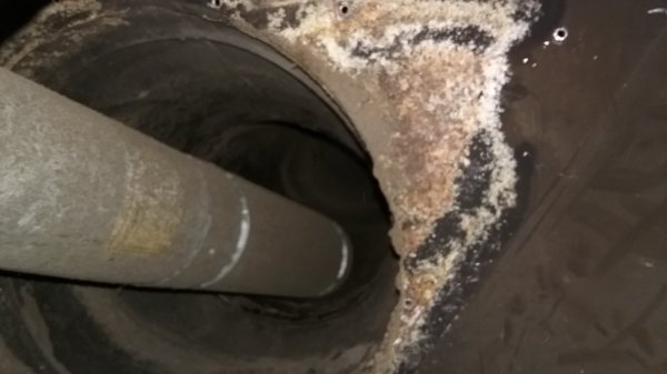

    check out the ash buildup on the pipe and stove collar itself. Looks like it may have come through leaks.....if ash can get through, you had better believe CO (Carbon Monoxide) is getting is as well......
  13. Well Seasoned
    83,789

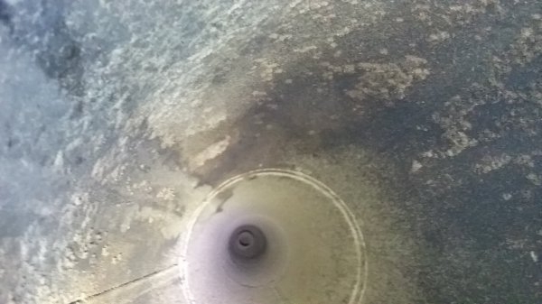

    I had some time to get on the roof and look down the chimney. DexterDay I was incorrect that the flue was going completely up and out of the chimney. Upon inspection, the pipe comes up only about 3'. So soon, I will inspect and correct the outlet pipe.

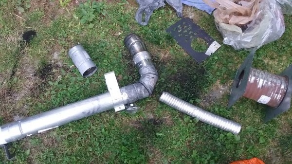

    Here is the stuff they had in the shed.
  16. Well Seasoned
    83,789
    Yea...... this is gonna need a complete overhaul

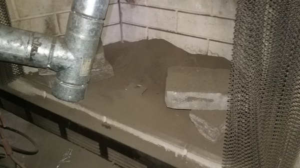

    Ok, I'm done for the night. I unscrewed the block off plate and wow....... filled! I'll clean up tomorrow and look at some options. Then proceed :hair: we've got close to a blockage, corrosiveness going on, and now miners lung.
