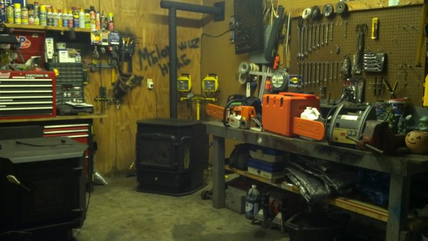

    As for pellets. I use between 2-4 ton (4 ton burning no wood.. 2 ton burning 4 cord of wood). Heating my 2,200 Sq ft (upstairs) and 900 Sq ft downstairs to about 72°-74°. :thumbs:
    I bought the same sister stove (10-CPM). Great unit and will burn anything. Sold mine to my parents when I got the deal of a lifetime on my Enerzone Eurostar.
    In my shop/garage..
    In my parents house..

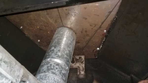

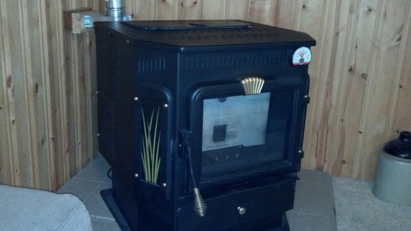

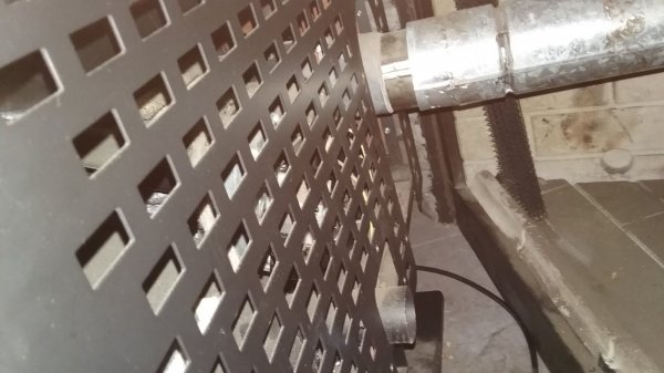

  19. Well Seasoned
    83,789
    Here is a pic of the back of the stove, up the chimney, and a bag of pellets.
  20. DexterDay
    DexterDay Administrator
    12,411
    31,637
    Northeast Oh
    How far up the block off plate does the flue go?
    If it doesn't go to the top, Ash will build up in that area and eventually block the flow (if it only goes up a food or two above the plate).
