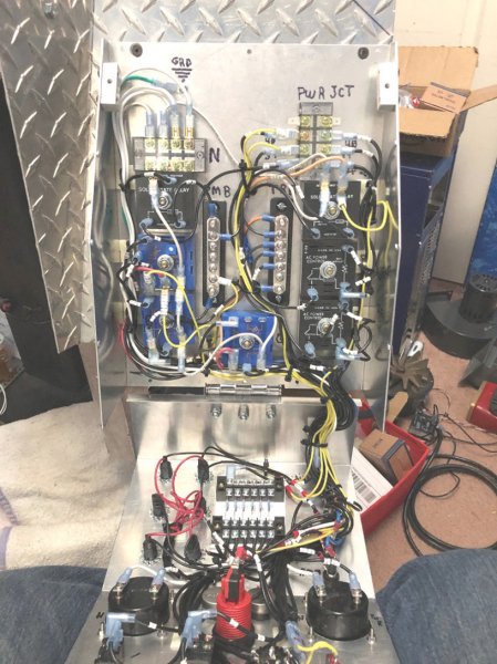

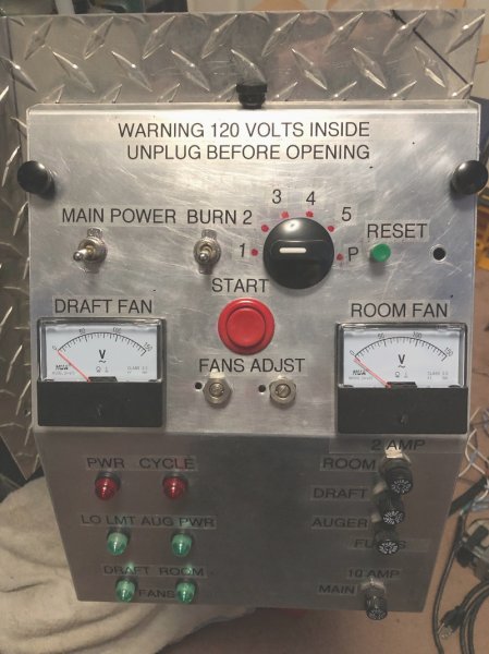

  6. Snowy Rivers
    2,855
    12,513
    Actually the controls I did were not that complicated and used all off the shelf industrial parts....
    What do you need to do...how much do you need...when do you need to do it....
    All hard wired....LED indicator lamps to show wasssssup....real time volt meters to show fan voltage
    Each component in the stove is individually fused......
    I added a manual reset snap switch on the vent pipe....In case there was an over fire and things got hinky the snap switch will open at 250F and shut the power off to the feed motor.....stove shuts down.
    Snap switch must be manually reset ......A safety device that can't leave questions.....IT GOT TOO HOT...

  15. Snowy Rivers
    2,855
    12,513
    Since both our stoves are Whitfield I decided to build two controllers....Both stoves had issues with the factory controls and were in need of repair.
    There were/are outfits that offered repair services on the factory boards....Sadly the factory boards had issues right out of the gate.....So fixing them really seemed like a bad choice....
    I wanted more adjustments on all the functions as well as better safeties ....
    I also wanted parts that can be replaced in a hurry when its going sideways and cold
    jtakeman and SmokeyTheBear like this.
