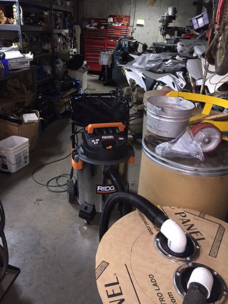

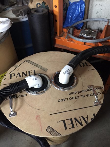

    All done now and it works like a charm.
    The new shell transport device is a result of some great help from the folks here and a bit of McGyver application technology.
    A round piece of concrete form plywood (Has hard laminate on it)
    Two toilet floor flanges
    Some PVC fittings
    Some screws
    Two handles to lift it
    Some putty tape to seal the flanges air tight
    Things are pretty self explanitory

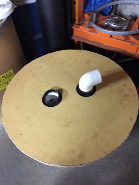

    The bottom view shows the one elbow to keep the suction from picking up shells as the blow in and down from the center port.
    Easy connections without any mods to the big Ridgid Shop vac.
    This thing SUCKS :rofl: :lol:
    Aside from that it works sweeeeeeeet :yes:
