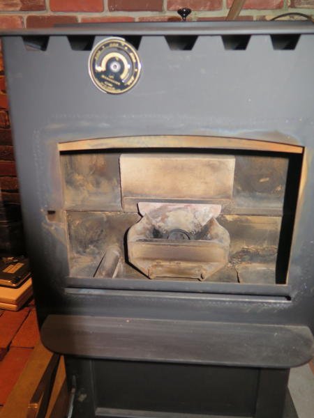

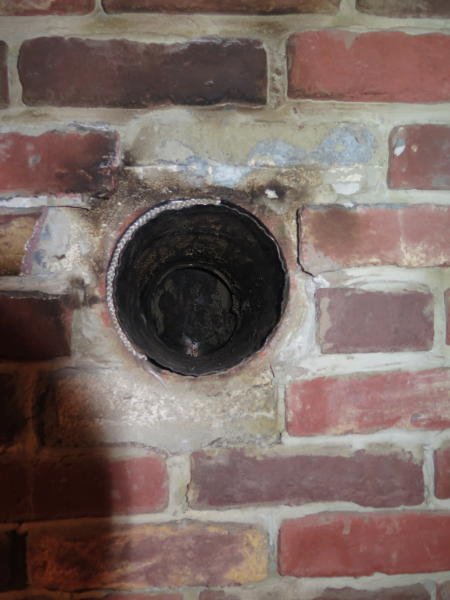

    And the after pics

    I'm a little surprised it was that dirty. I tore mine apart today as well and I had just a light coating of ash on the inside of the pipe. IIRC you don't run an OAK. Could that maybe be the difference.

  5. will711
    will711
    10,271
    50,834
    Pocono Mts.
    I happy that the pipe was only coated with ash no creosote , and that's with 2 90's to get it to the chimney and one to get it out . Pics may make it look worse may be a 1/16 of an inch or less thick .
  6. imacman
    imacman
    Oct 23, 2013
    6,636
    27,536
    Denver, NC
    IMO, those are pretty heavy build-ups. Not sure I'd let mine get to that point. I probably wouldn't let mine go more than about 1 1/2 - 2 tons before cleaning with Lint-Eater.

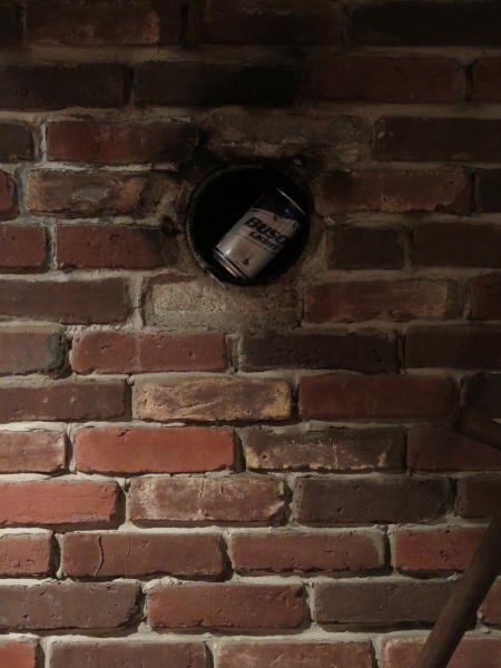

  7. imacman
    imacman
    Oct 23, 2013
    6,636
    27,536
    Denver, NC
    What's that doing there? That's going to cause a lot of back pressure.....get that thing into the burn pot where it belongs :D
  8. will711
    will711
    10,271
    50,834
    Pocono Mts.
    I hear ya Pete , this was the first year so you see what happens and that is a 4" pipe not a 3" so the stove was'nt chocking itself , but I prolly will pull the pipe mid season for a cleaning , now that I have a bench mark .

    Pocono Mts.
    That's a CYA before some one says that something is missing from my pics :rofl: :lol::rofl: :lol::cheers:

  10. imacman
    imacman
    Oct 23, 2013
    6,636
    27,536
    Denver, NC
    Especially important with the # of 90's you have.....even though it's 4", all that drag can't help.

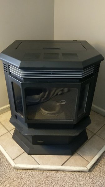

  17. slvrblkk
    slvrblkk
    6,649
    29,546
    Northampton, PA
    Well she's officially ready to go....although I hope it's a while yet for that.
