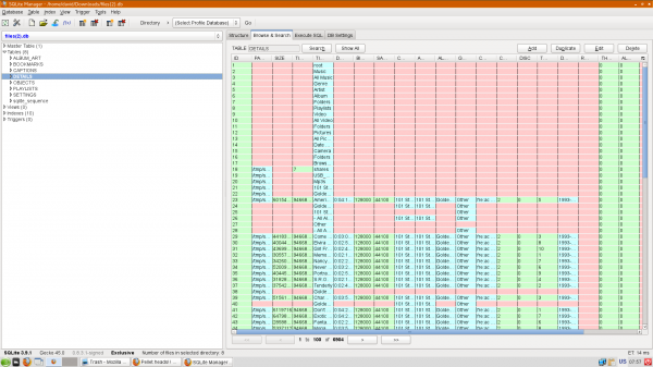

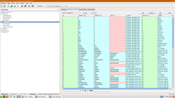

    Well, here is the latest in my saga of getting a fully functional set up for serving media over my network without having to leave the computer system powered up.
    I just got through level 3 again and am awaiting the engineering gods to speaketh.
    Response from NETGEAR
    Hi David,
    We are still checking this with our engineers. We will get back to you as soon as we have feedback.
    Thanks,
    Janice
    Man that trouble ticket is getting long.
    Ain't embedded systems just great?
    Did you folks know that a lot of the electronic crap out there can have its embedded software updated? Industrial strength it ain't and more of that crap is getting inserted in your vehicles.
    They made a big mistook in several areas and their can handle xx,xxx files is incorrect.
    My current loaded and usable media collection contains:
    ReadyDLNA status
    Audio files: 4994
    Video files: 326
    Image files: 0
    I tried adding my photos and somewhere around a thousand the gateway rebooted. Funny things happen when you try storing a sql database in memory instead of on an external device.
    The database supporting those files has 6902 detail table entries:
    Screenshot - 03142016 - 07:57:18 AM.png
    And 35,843 Object table entries:
    Screenshot - 03142016 - 07:56:38 AM.png
    which requires 14,155,776 bytes to store.
    There is 128MB of ram in the gateway and there is a lot more there than just this database.
    The first unit a C3700 walked on the DNLA server software when this got too large, the C6300 hits the reboot trigger and the gateway resets. Back a few months ago versions of my favourite media player managed to chew up several giggles of memory on my 16 giggles system before crapping out, took a while as well.
    Ain't software just wonderful.
