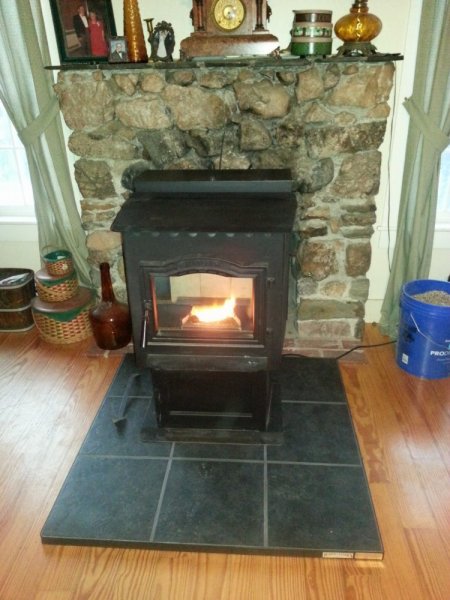

  20. Hoot23
    Hoot23
    Oct 27, 2013
    166
    157
    Alfred, ME
    Up and running. Sorry it's sideways, can't figure out how to turn it.
    gbreda and will711 like this.
