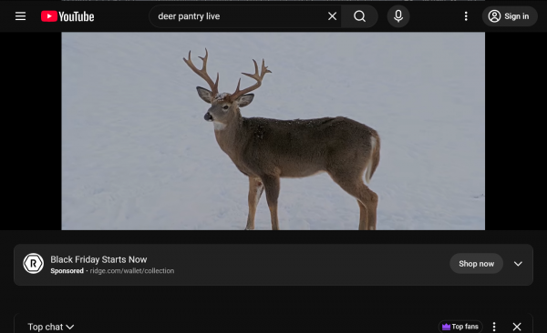

    Well,well look at what showed up at the Food Panty for Deer.

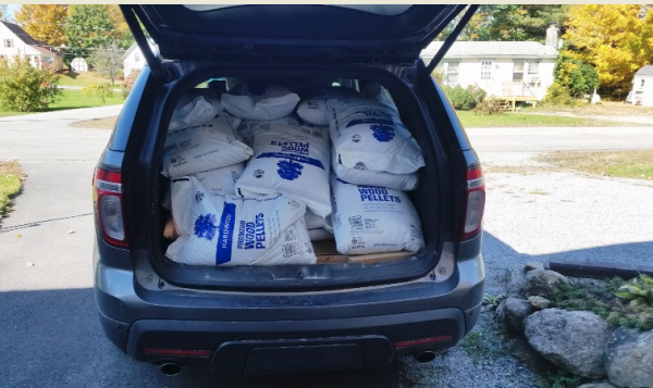

    Hey you guys how’s it going? Glad to see some of the OG people still here. I got a ton of TSC red bag pellets delivered yesterday and the Roadie delivery guy showed up with a Ford Explorer stuffed with my 50 bags. To top that off he was in Jesus shoes and a black leather blazer, no gloves, no hat, no warm clothes and the wind chill was 7 degrees. But this guy unloaded and stacked those bags in ten minutes flat like a boss. I was impressed. Thought you guys would get a kick out of that. Brother and I moved them into the porch a few hours later. Roadie only delivers to the driveway but all good.
    My 2005 St Croix Prescott is still pumping out the heat. It’s 5 am - ish and outside is 4 degrees but 73 in my living room with the stove on setting 2.

    That brings back the days I used to do that - load my Explorer with a ton of pellets. Red one was 2007 Explorer, gray one was the 2014 Explorer. I think I've done this at least once with my current 2018 Explorer, but can't find pictures so maybe not (bought late 2022 so may have already had all the pellets I needed - last 2 years I've gotten deliveries from HD).

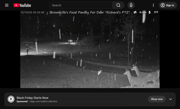

    Feeding starts Tuesday December 16th
    Screenshot 2025-12-10 at 07-04-15 Brownville's Food Pantry For Deer Richard's PTZ - YouTube.png
