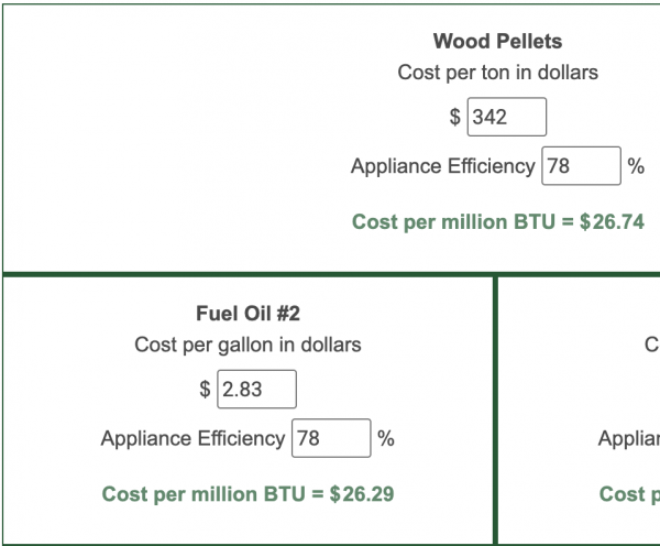

    According to the fuel cost calculator, your about a wash between the two at those prices:

    If you don't count the sleppin and cleaning. I wanna say the furnace is a bit higher than 78%, 82, And IIRC pellet stove was 76%. If it makes much difference?
    Like I said 100 gallons equal right around 1 ton of pellets. Most likely cause the pellet eater heats both upstairs and the basement where the furnace heat more upstairs.

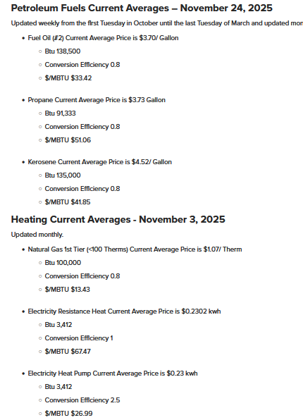

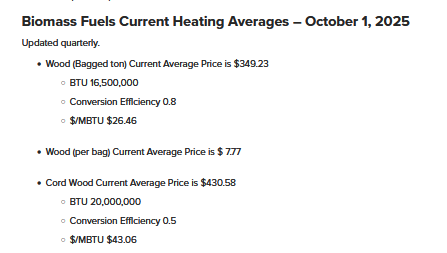

    HHO is averaging $3.70/gal here according to the latest report. More expensive per BTU than pellets
    Pellets are cheap per BTU compared to oil, and what is up with the cordwood prices - the only things more expensive than cordwood are resistance and propane (which is always the case)
