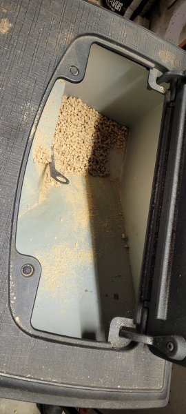

    I think one of my garage door openers slipped into the hole where the handle is on the lid....I'm gonna let it run out and check 20221125_172630.jpg

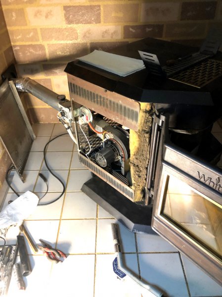

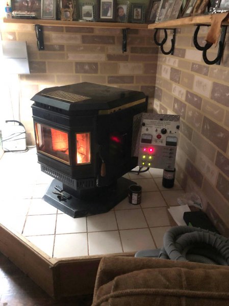

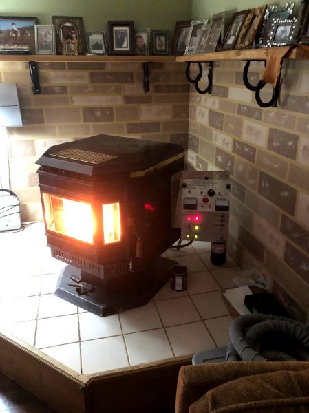

    Had to put the big Whit in dry dock this morning.....Time for the early season full house clean out
    Pretty skunked up......
    Cleared out all the baffles and run the "WA WA BRUSH" UP IT'S INNARDS....
    LBT TOO
    Removed the exhaust blower and cleaned out the housing and wire brushed the petals on the fan blade.
    The area between the fan and the cover plate was packed full of crap too.
    Oiled the bushings good...
    Got her all back together and lit off the fire
    The one piccy shows the one middle row inner green lamp is not on......This light illuminates when the low limit switch closes and the power flow transfers from the startup timer to the main power buss....
    The other piccy shows the inner center green lamp on. Takes about 15 minutes or so.....
    A touch longer after a full deep cleaning...."Better air flow" and the unit heats up a bit slower.
    All good to go now.....Just a filthy job......
    May do it late winter or spring again.
    Regular fire box cleaning is weekly.....Outer baffles are every two weeks....
    Washed the windows....GOOD TO GO....SNOW COMING NEXT WEEK....
    IHATEPROPANE, bogieb, Dpopps and 3 others like this.

    With our old Whitfields running the shells....About 3 times the fly ash as pellets.
    One super deep clean about this time of the year....and then the fire box every week and every other week clearing the baffles too as well as a LBT every other week.
    This keeps the vent clear and the draft good.
    Today the rains let up by 10:30 and we managed to run 3 barrels full through Munchy......
    Good for several days.
    Next decent day we need to go after load #3 and get it in before the deep winter gets here....
    The Big Whit sure runs sooooooooooooooo much better after the deep cleaning.
    The inner passages really clog up with ash.....Poor design with way too many sharp bends and other nooks and crannies that catch the ash..
    90 degree corners with nasty welded areas and stuff protruding into the air flow.
    The scrub with the WA WA BRUSH AND THE LBT really clears it out good......
    That stove has such a torturous path from the fire pot up through the heat tubes, then down into the primary ash baffles....A dead stop and reverse direction and up...though a slot and then 90 degrees down into the secondary baffle....Then sideways to the passage into the center of the stove....Then a hard left turn into the exhaust passage....A hard right through the draft control into the actual fan housing....Then out the back of the stove.....A bit over 3 feet of horizontal run...A 45 degree and another 18" out the wall....
    Amazing it works at all
    A high pressure air hose directed in to the innards with the fans running really does good....BUTTTTTTTTTTTT...Way too easy to make a big azz mess in the house if the air nozzle gets just off a skosh
    Too many reversals......
    But the old Whitfield Advantage 2T are still a good work horse.....
    Just need a bit more TLC IS ALL....
    IHATEPROPANE and bogieb like this.
