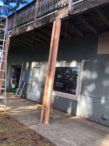

    The other day when we were running Munchy....I was bringing in barrels of 1/2 shells to crush and just happened to notice one of the tall posts on the deck looked a tad odd......o_O
    It had a large knot that had fallen out and a big azz crack running sort of diagonal up through the center of the post.....One spot looked a tad "Pithy" but was not really bad....Wood peckers been poking at it some....
    We get heavy wet snow here and can get a bunch on the deck.....I started getting nervous about that post.
    A big job to jack up both beams (Posts are between two 6"x 12" beams) and stuff in a new post.
    Decided to add one new post on either side of the original and lag then in......
    Measured things real carefully and made the cut....Sweeeeet....They both came out to be a 5 pound hammer snug fit.....Put 4 long lags on each side...Staggered so they did not hit....
    I am going to sleep much better now...
    The posts are 10'-10" tall.....
    New ones were a tad damp....Douglas fir.....Straight and minimal knots
    Much better feeling after getting the new posts in place....
    Today the 4x4 posts would not be allowed....6x6 is the standard for this height.
    Our deck was built back in 1993 and passed inspection then......Having the extra posts is much better.....
    I always wondered about those tall skinny posts.....They have held up to 2 feet of wet heavy snow and then ice on the deck and always held fine.....BUUUUUUUUUUUUUUUUUUT ??????
    After nearly 30 years up in the weather.....Better to fix it.
    4x6 posts would be fine on this application......I never liked having only 1/2 the width of the post under the beams...
    Thinking that we may go ahead and add a pair of extra 4x4 on the other posts all the way across.....JUST BECAUSE....

    I think you have a good plan to go ahead and add the extra posts - Definitely better safe than sorry.

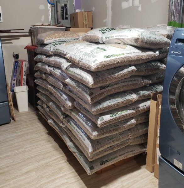

    During the solar install, I had to clear the space in front of the breaker panel (it had a clear walkway and access, but I didn't know if the guy working at the panel would be extremely hefty - plus, didn't want to give town inspector anything to be fussy about). While that corner was clear, I decided to get that portion of the wall more "finished" - up to this point it it only had rigid foam and a layer of Reflectix. So I installed some furring channels and a couple of pieces of sheetrock (leftovers from other projects). Then set up my oversized pallet that holds 8 bags to a layer, and brought in 80 bags from the garage. In the first pic, the green strip of sheet rock and pink foam is just there for a place to store them that is out of the way.
    This pic shows 78 bags, but two went into the stoves to fill up the hoppers.
    And yes, there is plenty of room to fit between the pellets and the wood chests to get to the breaker panel.

    Exactly.
    I am thinking about doing all of the posts across the front and adding posts on each side.
    30 years on this deck......A big crash in the dark of night would suck......
