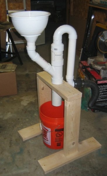

    Yes, I made one. See pics:
    Pellet cleaner 1.jpg Pellet:corn cleaner - parts1.jpg
    I also made a modification since my vacuum was bigger than originally needed, so I could cut down on the amount of vacuum....just a piece of PVC with a section removed.....I snapped it around where the holes were, and I could rotate it around to open or close off air holes until i got just the right amount of vacuum to clean the fines, but not suck up any pellets. The "hopper" was a plastic bowl I got at WallyMart:
