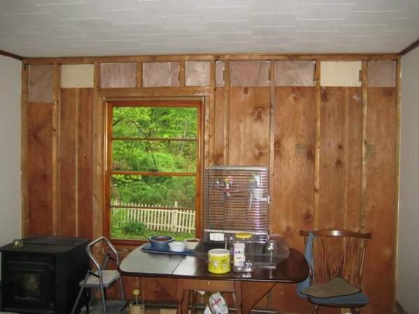

    So this is what the walls along the perimeter of the house looked like when I tore out all the sheet rock and old insulation (that was only about 1" thick). Yes, those are 9-11" gaps between the top of the plywood to the the ceiling framing. There is no house wrap and there was no plastic or any kind of moisture/air barrier. The ceiling is tile instead of sheet rock, so there was no tape/mud at the corner to help reduce air infiltration. They just covered the sheet rock / ceiling tile gap with crown moulding (did not use any adhesive or sealant) and called it good.
    I custom cut plywood for each gap and then sealed the gaps from there. (and I had someone replace all the windows)
    Put in R13 insulation (only 2x4 studs so couldn't go with R19), plastic and 1/2" sheet rock (what I tore out was 1/4").
    The kitchen is still like the first picture (except I haven't torn out the walls so there is still a little bit of insulation and 1/4" sheet rock). But until I'm ready to commit a whole bunch of money to replace everything in the kitchen, that is the way it will stay.

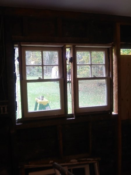

    Most old homes only have thin tar paper and the joints aren't sealed. The new fangled stuff makes a big difference. Our kitchen was 1960's era, We demo'd it and I chnged out the 1939 era window. Plus resheeted the exterior in the worst spots to replace the slab wood they had built it with. Area's of the slab wood had 1" plus gaps. Absolutely no insulation at all!. I put up 2 layers of 1/2 plywood(stagger joints) on the exterior and tapped all the joints. Put up a radiant/themal barrior house wrap and tapped all the joints. Wrapped it around the window openings and sealed the window as well. Also put 1" board insulation over the house wrap.
    Second pic is the trial window fit before the house wrap was applied. I didn't take a pic of that. I was soo bonkers to get this place rady to move in to. But it was way better sealed up from the old!! I also foamed any remaining gaps too!
    Then R15(max for a 2x4 wall I could find) in the wall cavities. Plus a radiant/moister barrier over the insulation. I wished I took more pic's, But its the warmest room in the shack besides the chitter!! All the exterior walls in the shack got R15 rockwool/stonewool insulation and the interior radiant/moister barrier over the insulation.
