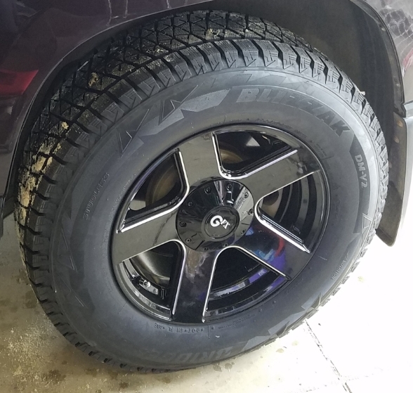

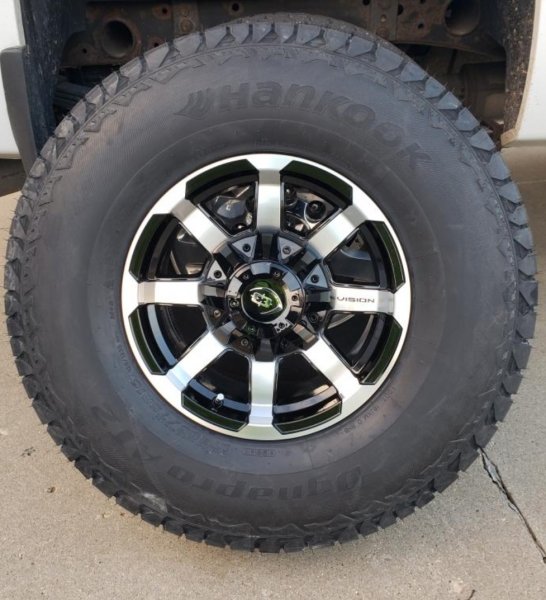

    Blizzak on the wife's ride, hankook on my truck.
