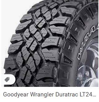

    Nokia and Blizzaks are very similar and very good ice tires. Used Blizzak on my front wheel drive vehicles until I went Subaru and then 4wd trucks (yes drive responsibly even with 4wd or end up in ditch, median, abutment etc). Didnt really need the ice tires or sn*w so much at that point. Michelin LTS M+S work great on 4wd trucks as year round. Never once been stuck driving in all weather.
    Current Colardo rig came with these beasts-Wrangler Duratrac. Noisy but traction to spare
