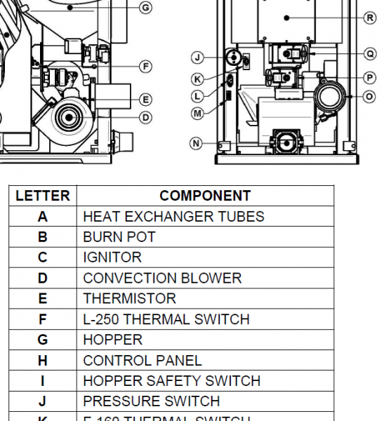

    First leaf blower trick on this stove, is thing to disconnect called a "pressure switch"? Letter J below?
    I had it marked in my previous stove and for some reason I thought it was called a vacuum switch.

    Yepper. Actually a good suck job has never impacted mine at all. If you do disconnect the hose, clean out the fitting and make sure the hose isn't cracked or hard. You can buy replacement hose on most pellet part sites. Regular fuel hose ir clear vinyl hose won't take the heat and will fail quickly. Has to be silicone rubber hose.

    Thanks! So, hose it is.

    First LBT in too long. I've been using the soot eater but a bunch still came out. Glad that's done, it's been on my mind, and quite an ordeal to set up and do here.

    Hoping it's not a fluke, our newer model of the same stove is burning A LOT better after the LBT today. Some of you might remember I posted about this new stove not burning as hot as the previous one. Called tech support months ago, performed all the trouble shooting with no improvement and gave up chalking it up to the constant high winds here and a change in models between our old and new stove. I'm wondering if something was wonky/ajar from shipping and the LBT sucked it back into place?
    Hooked it all back up and lit it, ran it on the lowest setting, 1 (of 6 feed settings) for awhile. Wind kicked up so I turned it to medium, 3 (of 6 settings) and it smelled HOT (you know the smell of hot metal, that smell). Flame is high and dancing more than it ever has since installing.
    Crossing my fingers this lasts!! But also driving my crazy I don't know what the difference is that made this improvement. And, LBT atleast once a year from now on!
