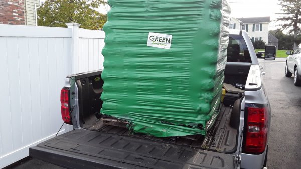

    Same down here, maybe a first frost ? Took advantage of the cool am temperatures to haul a ton of Greene Supreme.

    Truck question...Is that a half ton pickup, and if so, you have no problem carrying a ton of pellets?
